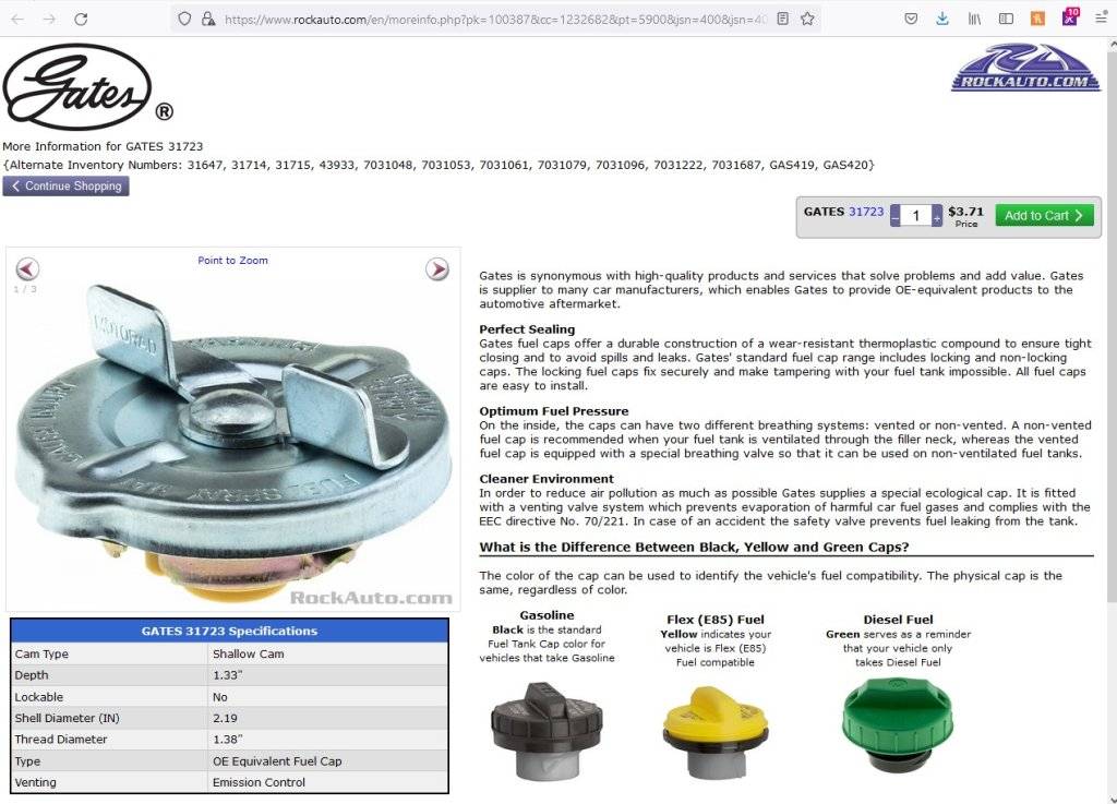

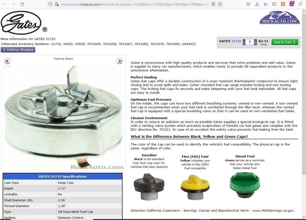

Rock Auto also shows a vented cap in their listing, but I don't think it's correct for a '71.

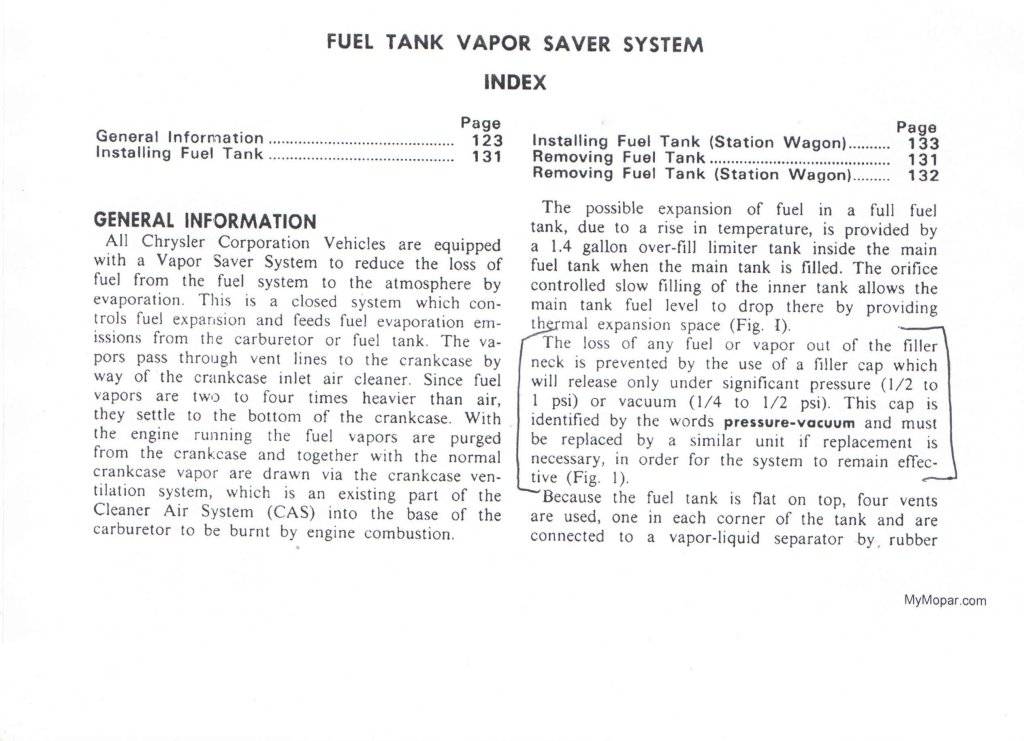

Hi Jeff
I mistook the pressure vacuum cap mentioned in the FSM to be vented. My gas tank has 4-vent vapor separator.

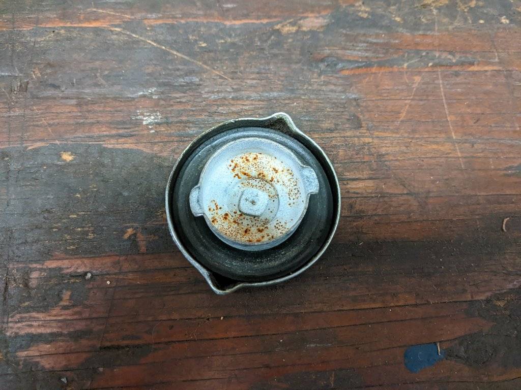

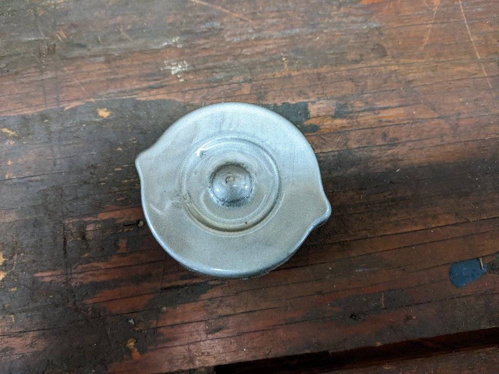

Could I try the 1970 cap to see if it is earlier?
It's worth a try. The listing for 1970 caps is all over the map, and I'm not sure which part numbers are actually correct.
Jeff
1970 Gas Cap does not fit. It can't lock against anything, just turns forever
1 5/8" tab end to tab end
3/8" tab width
2" cap ID

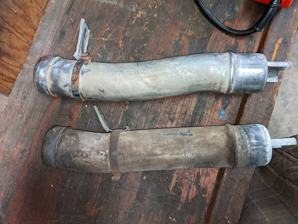

1971 Filler neck on top
1973 Filler neck on bottom
Runners are bent in 1973 filler neck, but the fit of the gas cap is about the same in both
Don't see any part numbers. Not sure what to measure. Hmmm
