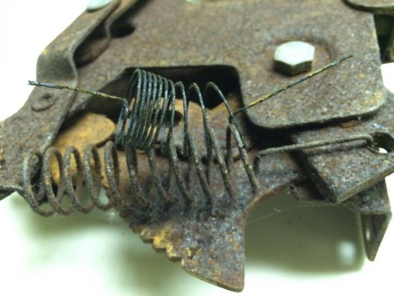

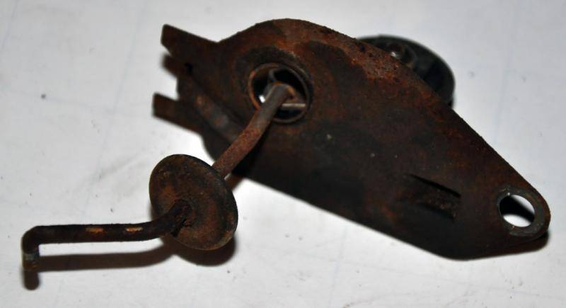

I put some parts in vinegar to clean like I have done many times before, same vinegar, same store, etc.
I did forget to check on these for a few days but overall they were in less than some other parts I have done.

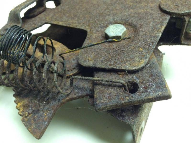

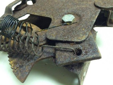

This is the parking brake spring, it looks to have eaten half it away...
This is the clip that holds the speedometer cable in...
These parts were in good shape and not already rusted through.
There were also some nuts with captive washers that the washers were thin and detached.
Alan
Yes, I have seen this before, vinegar is highly acidic and when it comes to thin metal parts they can be eaten away quite effectively.

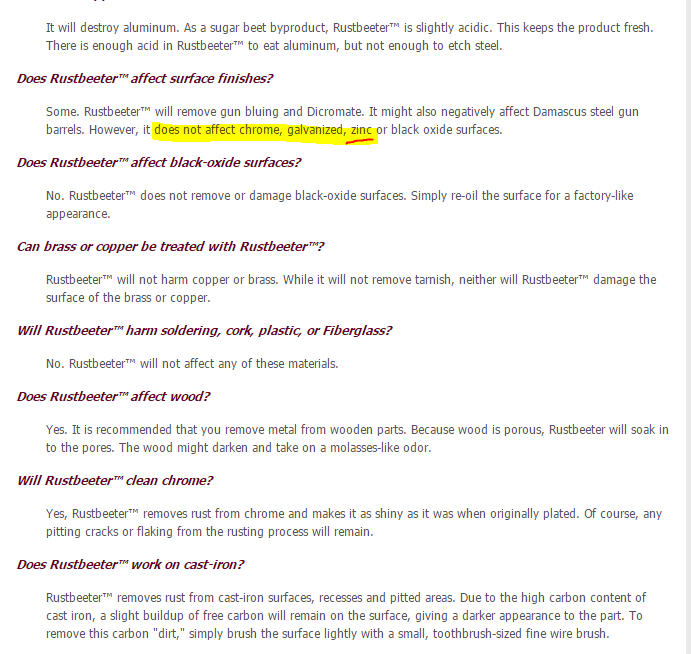

i use rust beeter. it is a very good rust eating product, made from beets. soak your parts as long as you want. only eats the rust. been using it for years now. a pail will last about 3 to 4 years. very sloppy though but works wonders.

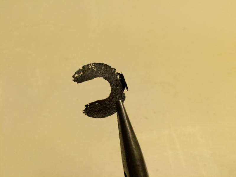

I made the same mistake last year with OEM u-joint retainer clips with the flat metal tab used during the factory assembly to keep the caps on the u-joint.
They had some minor surface rust and I was sure I could score a small reward on EBay for those that have to have the 100 point restoration.
I unfortunately forgot about them in the solution and they turned to powder!!!!:BangHead:

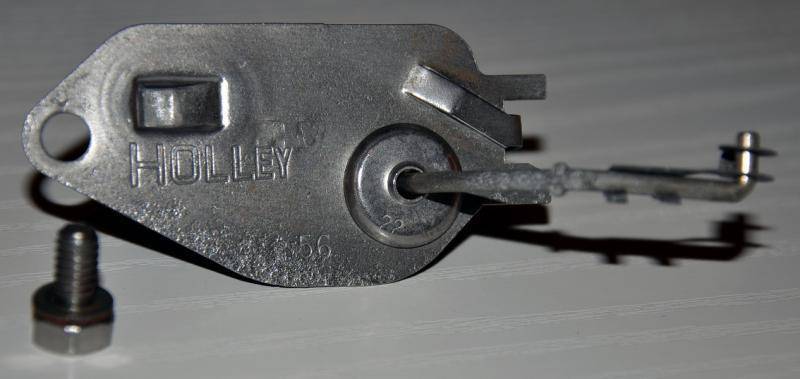

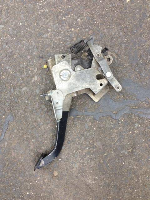

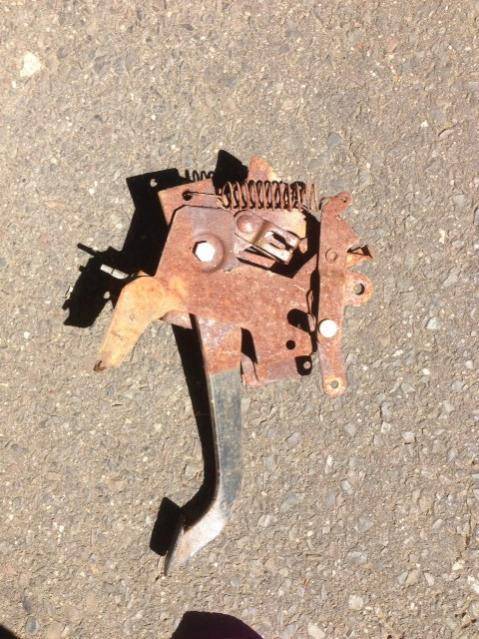

About a safe rust removal method, I used Metal Rescue, that's great stuff!
It did this:
That's a great information. My clips are broken and I can't remove them... Maybe I should try and soak the whole drive shaft end in vinegar to get them off.
And it worked for me as well! The retainers disintegrated completely after soaking approx. 8 weeks in 10% vinegar. The best way to remove them when the tabs are broken off! :)
Thanks Tom for the tipp! ;)
On mild surface rust, how long does it take for the RustBeeter take to work?
