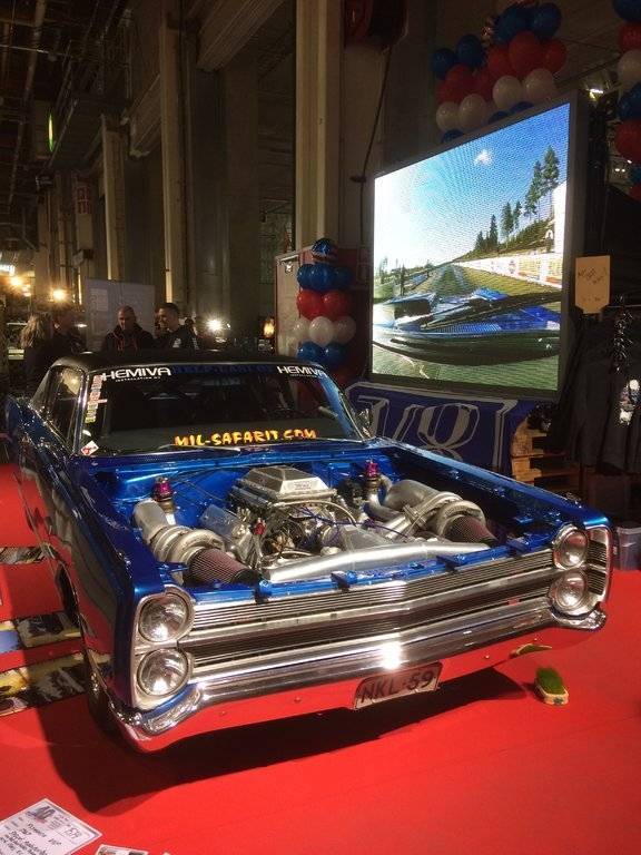

At Helsinki US Car Show in Easter 2017. Ordinary plates; presumably the strongest road legal car in Finland. I suppose there is no reason to doubt that claim.
