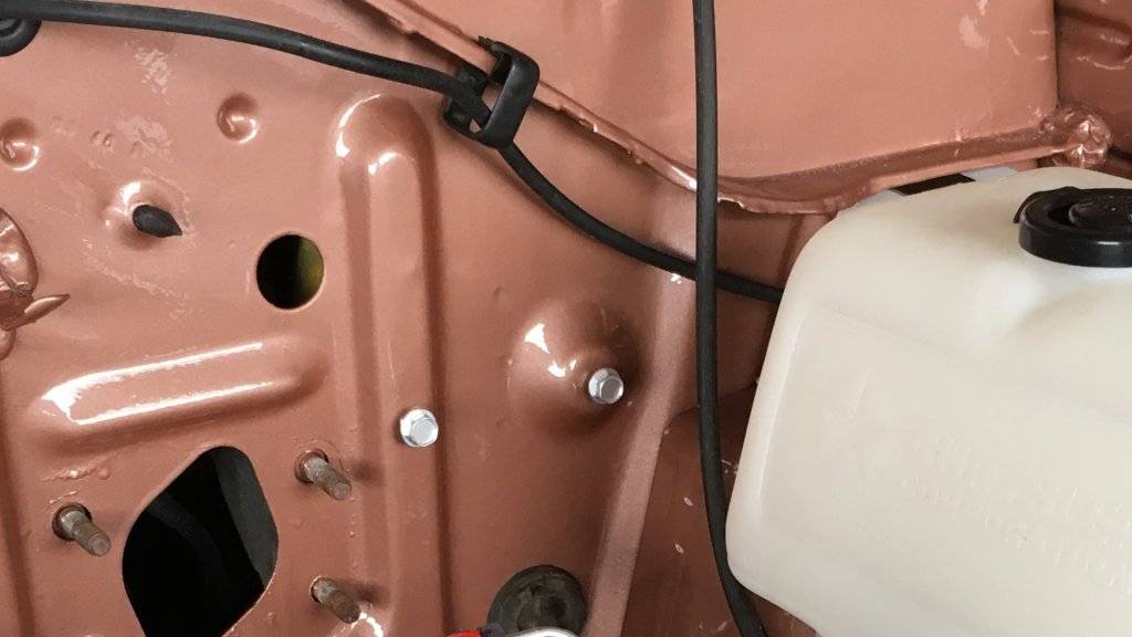

Any chance someone could share a pic and/or details for the mounting screws for a 1968 voltage regulator? I don’t think the one screw I have holding mine to the fire wall is correct (the fact there is only one is a tell tale sign)
This is my 67 Barracuda (my 69 Polara is the same)

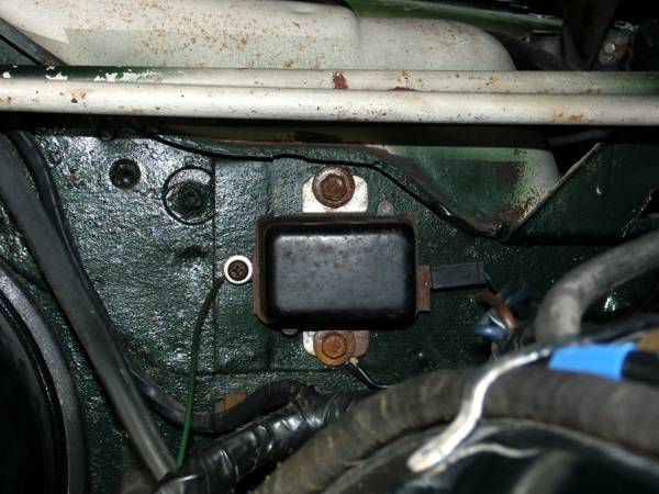

This is what I have ('67 Monaco):
The mounting screws are the ones on the top and bottom. The green wire on the left with the washer is not ground, it runs to the alternator I think. I'm running a separate ground wire on the lower mounting screw to the battery.

are you asking where they go ?
Asking about the screws themselves. There is only one installed on mine, and it looks similar to the one @MoPar~Man has, but mine doesn’t seem to tighten up all that much. I can see the lower hole in the firewall for the second screw too. I just wanted to confirm the style before going on a hunt.

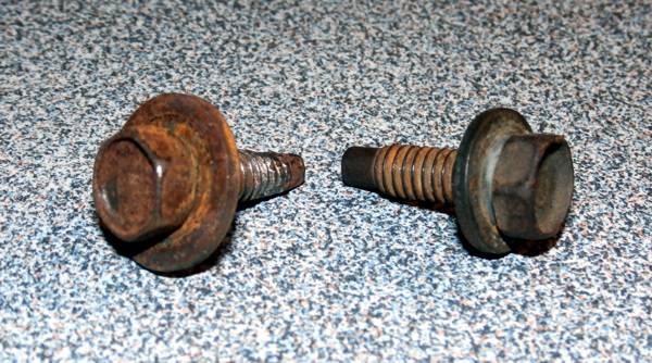

Here's a close-up of the bolts for the regulator and ballast resistor:
These look like ordinary body bolts to me. It's possible I did not replace them correctly years ago (they may have gotten mixed up with other body bolts).
The washer size is different (3/4 " vs 5/8) but otherwise they're same length and thread (1/4 " x 20 tpi). The head has a raised symbol, looks like L with a circle around it.
The BRE motorsports bolts don't look like these bolts. There has got to be better (more correct looking) bolts elsewhere.

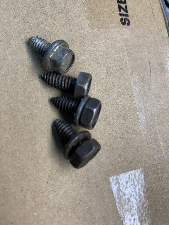

Mopar~Man … those are valve cover bolts . Here are a few of the various years of proper bolts . I can’t say what year each is correct for but I know they were used for fastening electronics to the fire wall .
I never throw out a fastener …lol
Im sure I have more.
