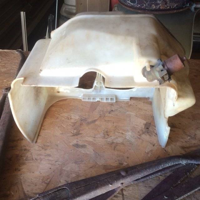

Washer Resevoir with pump
Like a 77 by chance? Post area has been cut (like most of them)

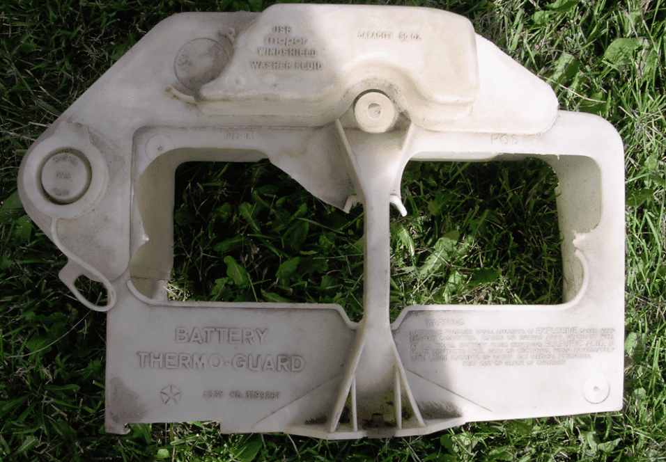

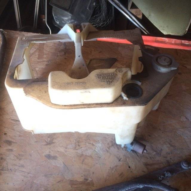

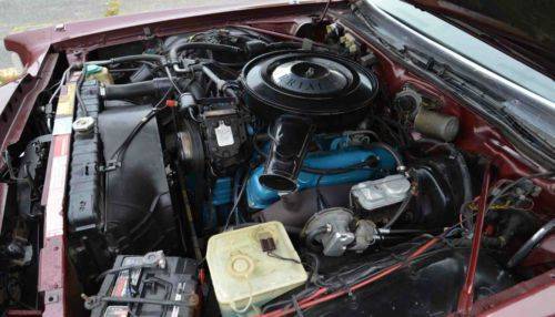

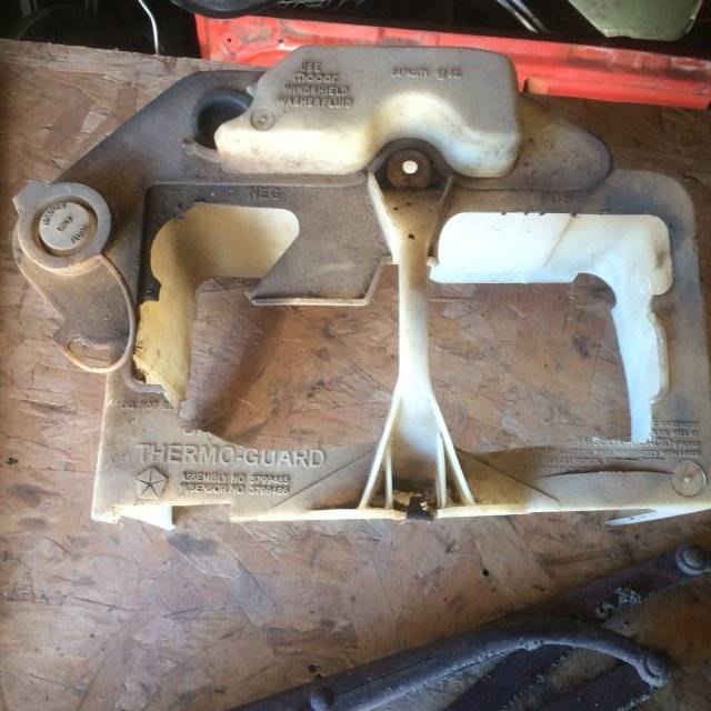

Yea, the washer bottle integrated with the battery Thermo guard...that's R body stuff. Formals have a separate Washer bottle. From 76-78 it was on the passenger inner fender. You can see it here by the coolant reservoir.

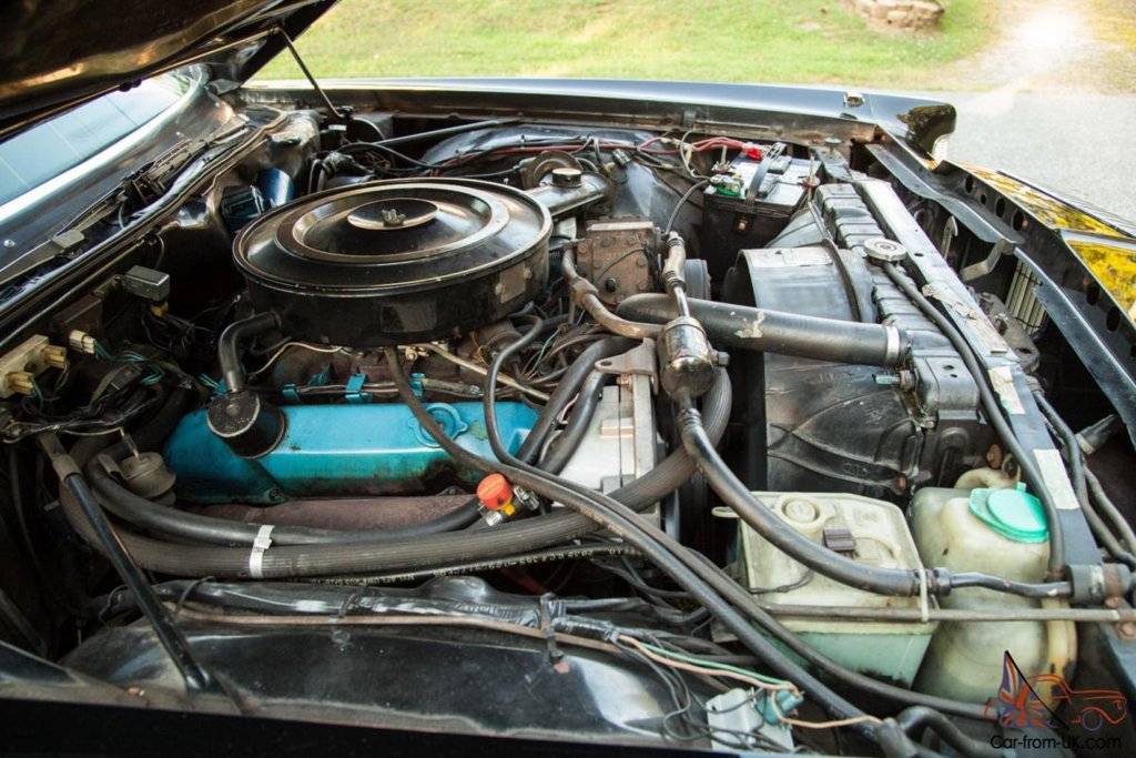

Of note the 74-75s had it on the drivers side by the battery...it was moved in 76...perhaps to make room for the LB air snorkel and hose?
Here's the 74-75 style (a 75 Imperial) by the battery:
By the way...they are the same bottle...they just turned it and fashioned a metal bracket to bolt it on the other side.
