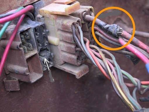

Are you talking about this hack splice?
Nah it was under the dash, but it the same vein as the picture, no noticeable solder now that you guys mention it. The tape was the old stretchy friction tape.
I wish it wasn't in the trash, it would be interesting to examine the method.
It didn't look like something a manufacturer should be proud of. I keep finding more poor splices every visit under the dash.
I think the wiring is almost acceptable at this point though. Every connection on the back of the fuse block was cleaned and reassembled as well.
