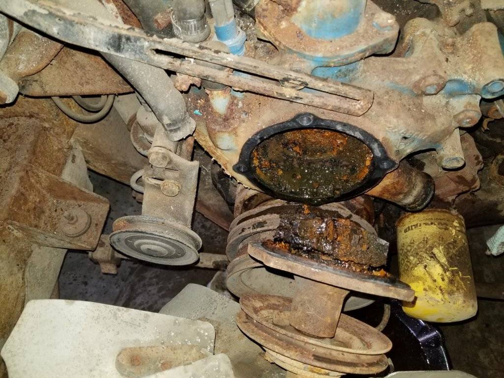

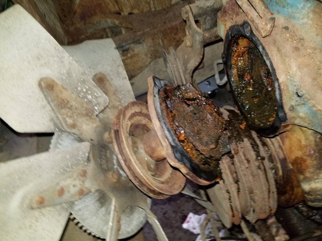

As we all know some projects take longer to start than others. Today I finally got serious about taking my '66 Newport apart. Here's what a cooling system looks like after sitting since 1981.
Wow! You got yourself an Alien eco system in there!!
There was actually about a quart of water at the bottom of the radiator/bottom hose. Smelled a little of glycol but looked more like water.
Also got enough out of the way to see if the crank will turn.
That's a negative, Houston.
Wow! I can only imagine what the water passages in the block and heads look like!
Since the old 383 is getting replaced with a 5.7 Hemi, it will be a while before I open that engine up.
But I'll post pictures when I do! :D
