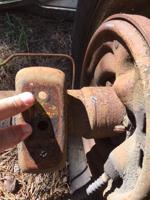

Jul 8, 2018 #1 C Body Bob Old Man with a Hat Joined Apr 8, 2012 Messages 12,041 Reaction score 18,965 Location Youngsville, NC Looking at my inventory of 8.75 rears I noticed that all of them have 3 holes in the spring perch. I know the center hole is the one used for the center bolt for the leaf springs but why the other two.
Jul 8, 2018 #2 Big_John Illegitimi non carborundum FCBO Gold Member Joined May 21, 2013 Messages 24,886 Reaction score 39,726 Location Marcellus, NY A semi-educated guess is they are indexing holes for when the pads are welded in place.
Jul 9, 2018 #3 BIGBARNEYCARS Senior Member Legendary Member Joined Dec 10, 2012 Messages 4,114 Reaction score 3,903 Location SHADOW OF MOTHER'S PROVING GROUNDZ WEIGHT REDUCTION
Jul 9, 2018 #4 Clover Well-Known Member Joined Aug 2, 2013 Messages 746 Reaction score 550 Location Southeast Michigan They also add strength! I agree that they are likely to be jig holes.
Jul 9, 2018 #5 M moper Well-Known Member Joined Nov 15, 2010 Messages 819 Reaction score 451 Location Eastern CT, 2 stoplight town, Columbia, CT Some other models use spacers too - they might help index those.
