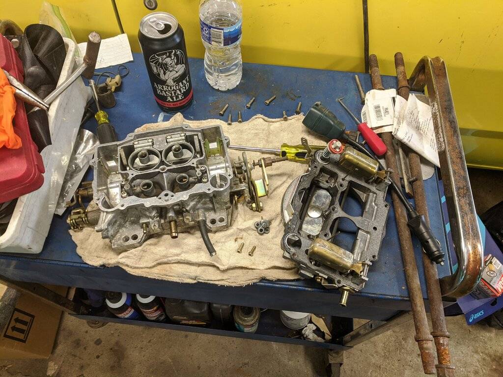

Tuesday, I cleaned my carb of the deposits I didn't completely clean last year. And I adjusted the floats. Runs better after cleaning a plugged squirter, but needs plugs now, might also have a lifter with a stuck plunger.
What an apropriately named brew...... not to attack your parentage, just your attitude. :poke::rofl:
I'd dump a quart of ATF in it and let it idle on that for a while. The last thing I had with a stuck juice lifter, ATF cured it before I was finished pouring.
Worth a try.

I'll give it a try.

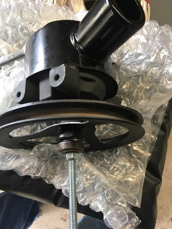

The power steering pump leak kept getting worse on my 300. I always wonder if they ever get better, but I guess not.
I was going to put new seals in the pump, but when I saw a rebuilt pump on eBay called out in another thread for $52 plus shipping, I decided to go that route instead. A little less work for me.
Pressing on the old pulley with a piece of 3/8 threaded rod, a nut and a nifty bearing piece from another puller.
All is good... Nice and quiet and doesn't seem to be marking its territory anymore.
