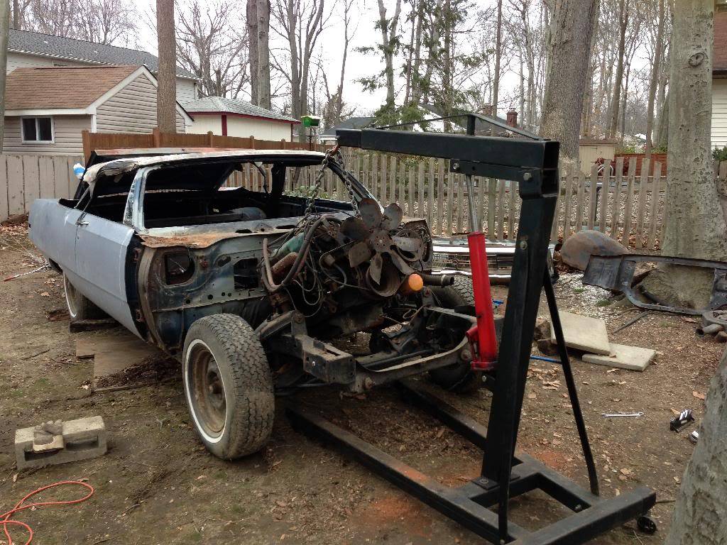

So hopefully the end of the year I will start the tear down on my 71 Polara called Delmae. At this point I will be replacing and rebuilding the front suspension and engine. I misspoke earlier and will formally correct it here: the subframe I got is from a 71 Newport. So now that that’s out of the way (like there’s not much difference anyways), what should I start looking for? I was looking at the PST rebuild kit. Has anyone found a solution to replacing the rubber isolators for the Torsion Quiet suspension? And who has used but decent headers for a 383?
