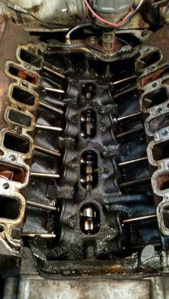

Now on to the intake! I know that those bolts should and will get thread sealer. But do you put anything on the intake gaskets? They are metal and have this bump that goes throughout the gasket. I guess it gets crushed when torqued down. Do I need to put rtv there also? The previous set didnt have any on it. And I suppose the foam gaskets at the front and rear of the intake need some RTV just to hold them in place, yes??

Paul, pretty much the consensus here among the Best & the Brightest, myself included I'm proud to say, is that on the intake, you put a PAPER gasket in each side of the valley pan and goo on all 8 sides of paper
I don't recall any foam gaskets.
Commando,
Attached (if I did that correctly) is a picture of the valley before the original gaskets were removed. There is no valley pan on this motor. It had 2 metal gaskets on each side between the intake and the heads (visible) and foam/rubber gasket to seal the front and back of the intake to the block. You can almost see them. And that is what was received in the Felpro gasket kit. Also there is no sealer/RTV on the metal intake gaskets either. So....."assuming" that the kit is correct....um, not sure what to say from here. :) I guess maybe a thin coat of rtv sealer on the gaskets and some on the bolts that go into the coolant passages. Yes??

For small blocks I like to use the Mr Gasket Ultraseal performance intake set. It's thicker and soft and it seals quite well. Better IMO than the factory designs. I use RTV in the corners and the end rails rather than the cork ends. Nothing on the ports or coolant passages. If you use the stamped steel 273/318 intake sets I'll use a very thin "skin" of RTV on the ports and coolant passages. 340/360 haskets are composite like the felpro stock type head gaskets. So no sealer used on them.
