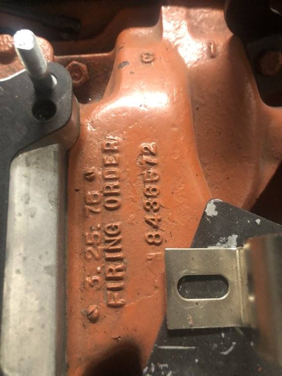

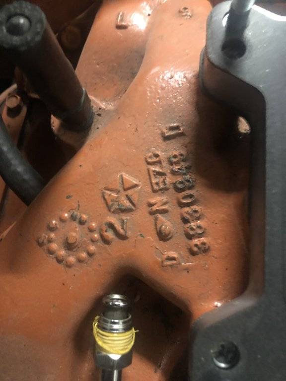

Hey guys I have a 1963 Chrysler 300, 383 4-speed. Ok so I want to purchase a new edelbrock performer rpm intake manifold. So I have a 383 block with 440 heads they are casting # 346. The intake manifold is casting # 3830848 dated march 1976 it’s a factory 4 barrel manifold. So my question is do I buy a manifold for a 383 or a 440??

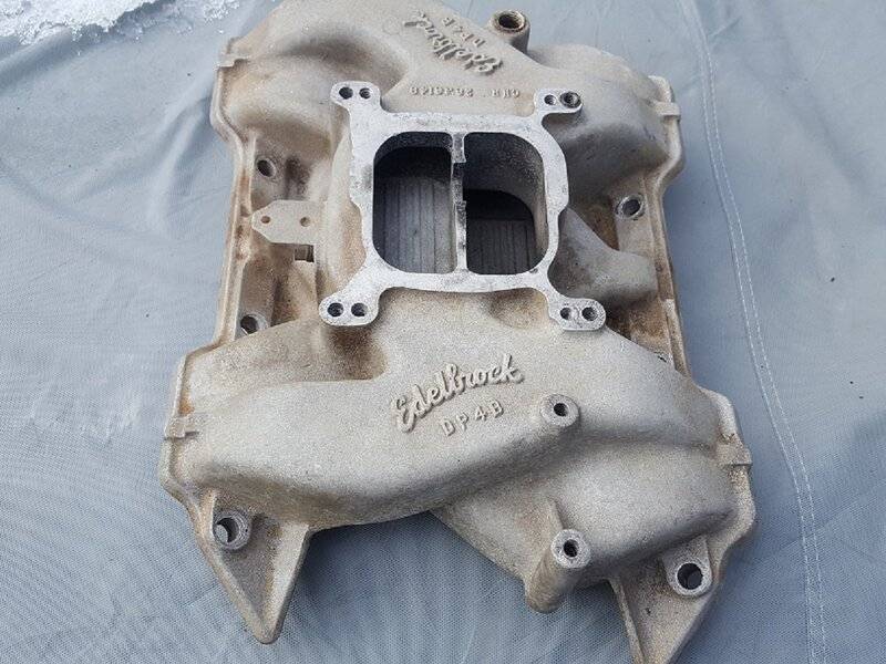

The old Edelbrock DP4B is a good one. Edelbrock Performer is a good one as well. Both are close to stock height and work with mild performance builds. A buddy used a CH4B (for 440) on his mild street 440 build and dynoed at just short of 500 horse and as much torque so they do work.
Good old DP4B, DP stands for Dual Plane, which keeps air velocity high at lower RPM, super intakes.

Buy the 383 manifold. Buy the right manifold for the engine size: 383. 346 heads and other street engine Chrysler factory heads are the same on 383 and 440. 383 has a more narrow width across the block between the heads. 440 intake will be too wide for your 383 because a 440 intake is too wide across the block between the heads and will not fit on top of your 303 block. hope this helps. Ben
B and RB engines can use the ame heads. The intakes and the blocks need to match but the heads can interchange. Like all heads, there are differences in port size, chamber size, valve size and springs of course but if you have a 383 you use a 383 intake regardless what heads you are using. If you are bothered about port mismatch, that can be addressed although for a mild street engine it isn't much of an issue.

And what carb are you using now on that '76 intake? Looks like you have an adapter on that spread-bore intake.

It's a "B" motor, a short deck big block (383, 400). Regardless of the heads, you need an intake for the block. "RB" blocks (raised block, or tall deck (413, 426 wedge & 440) have a longer bore so they have a taller block, which makes the intake a bit wider so the two intakes won't interchange the way the heads can. Get the intake for the 383.
