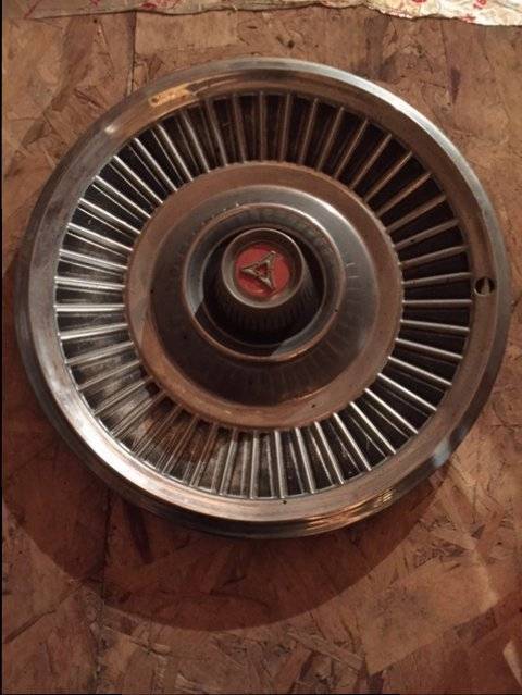

As, I am looking at my hubcaps, and want them to look brand new, I was wondering how did they detail them in the factory? My assumption is that they would have made some sort of automated stencil or die that was shaped to the dish and ribs. In my mind I envision them on a conveyor or rack system, mated up with the stencil, and then a quick spray of paint...... If anyone knows, let me know.
Now to the real question. Beyond painstakingly masking off each "spoke" does anyone have a better method to make hubcaps new again? and does anyone know the proper colors? of the black and orange on the hub caps? (1968)
Hand detailing is going to be the best method, the black was originally satin black and the orange was bright red.
  1. I'd clean it thoroughly with "0000" Steel Wool obtained from local parts store.
  2. Mask over all areas other than those to be painted
  3. Use a Q-Tip with some Vaseline and coat the top of the ribs where "Black" will be painted
  4. Paint areas & let dry
  5. Unmask covered areas & wipe off Vaseline
  6. Detail as needed

Thanks for the tips. I like hearing about all different methods on a number of things, and then experiment.
