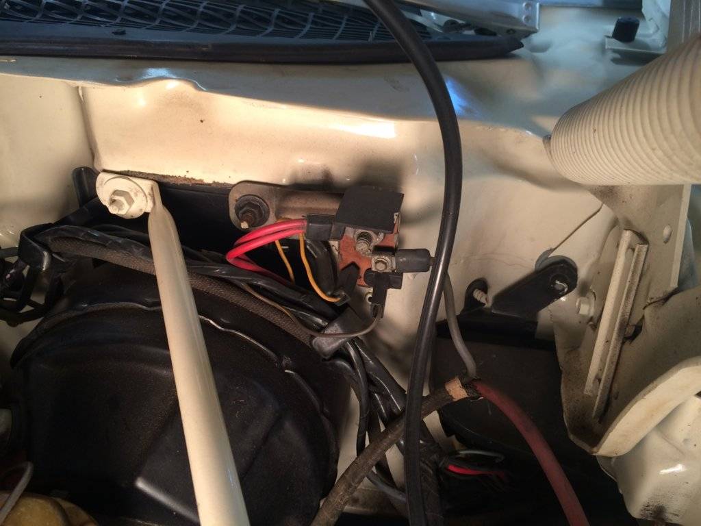

What is this part?
SteveinKY
Aug 5, 2016
35
4
Kentucky
It's the small box with 4 (?) connections going to it.
I'm looking to replace this part on a 1973 440 motor. Looks like there are only 3 connections (2 plug ins and a red screw terminal) instead of the 4 connections on my 1970.
A starter relay with 3 terminals is for a stick shift car. 4 terminals is an automatic car.
The 4th terminal is for the neutral safety switch and is the brown with yellow stripe wire in the picture.
EDIT: Brown with yellow, not yellow... Sorry, I was tired.
Always watch out for that big terminal when working with tools in the area....better yet disconnect the battery.
As they say, "try not to die"....haha
Many thanks to everyone who replied! The pic is of my '70 Fury. I have another '73 Fury being worked on that has the motor uninstalled. Currently there are only 3 wires visible in the engine bay (2 plug-ins and the red screw connection). I suspect the 4th wire would be the ground screw connection. I do have a reprint of the Chilton(?) manual. Both are automatic.
No, not ground. The red wires are from the battery. Yellow goes to the ignition switch (note my correction above). Brown with yellow stripe to the neutral safety switch on the trans. #12 brown wire (other screw connection) goes to the starter. You are missing the brown one because the engine is out.
