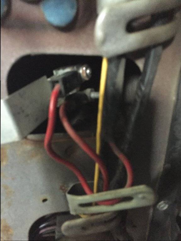

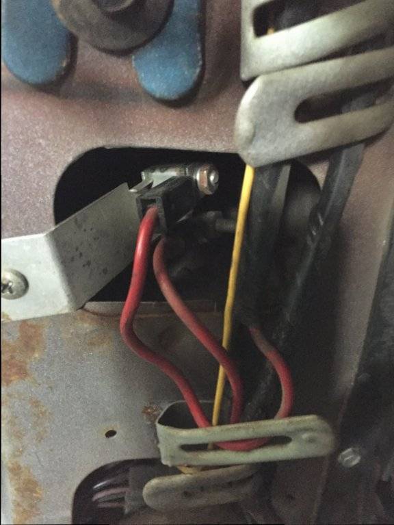

Hi all - I'm wondering if anyone can tell me what this is in the photo. It looks to me like a fuse of some type. I pulled it out and cleaned it up as all the contacts were rusted. It sits behind the driver's side kick panel, just behind the vent door. Two red wires going into and out of it. Thanks!

Judging by the size of the wire, looks to be a circuit breaker, more than a fuse. Possibly for power seats if you have them, or power windows.
If you had a factory service manual you could answer that question. I was thinking the same thing as Mr. Brougham.
Thanks - thats exactly what I needed here - the prod to the service manual! I do have one - online - and looked it up. It's exactly as you noted - a circuit breaker for the convertible top. Now if I could just figure out whey my courtesy lights don't come on when I open the doors!

it is the overload circuit breaker for the convertible top.

FWIW, that circuit breaker is also used for power seats as well.

Looks like a general run of the mill 30amp circuit breaker, I have used them a bunch on wiring system upgrades to help protect things in case they go bad on me. You can get those circuit breakers from 10-40 amps I think, and with mounting holes or not.
just google search "30 amp circuit breaker" and you can find all kinds of units available, with mounting on sides, ends or no mounting at all.
So you could just use your original bracket by drilling out the spot weld, then attach the new generic circuit breaker and you should be back in business for a lot less money then trying to find a NOS one. ;)
