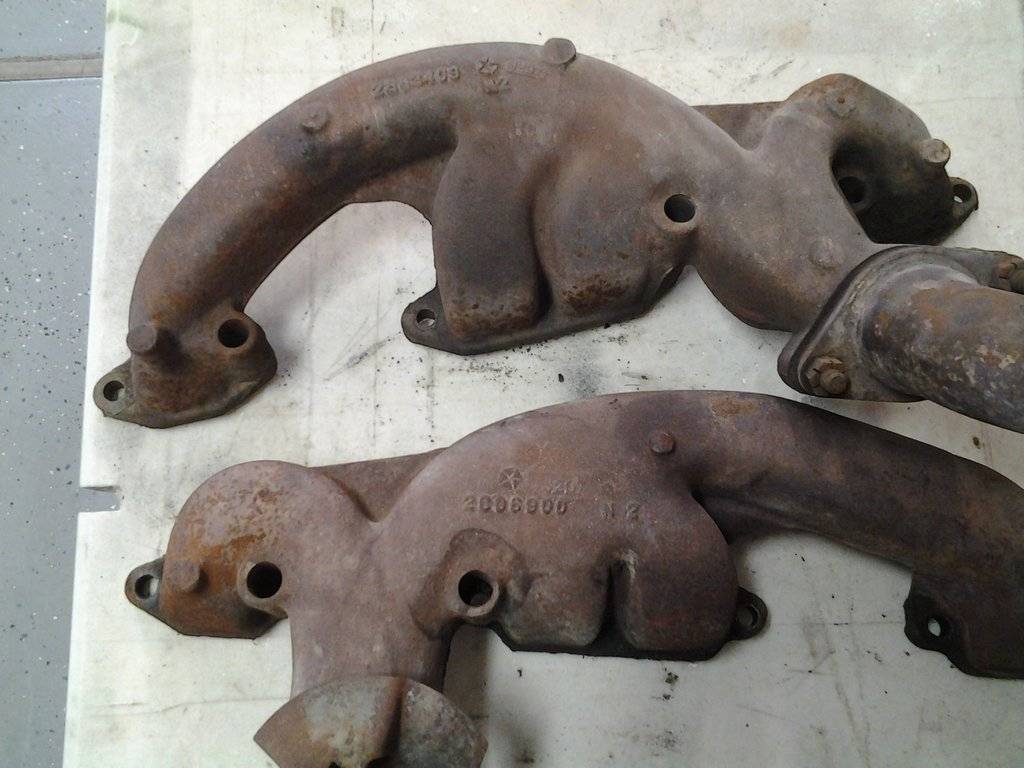

If you are going to use manifolds, use the HP manifolds for a '68 - '69 C Body Big Block. The right side HP manifold is the same as a B Body and can be pricy.
Bill

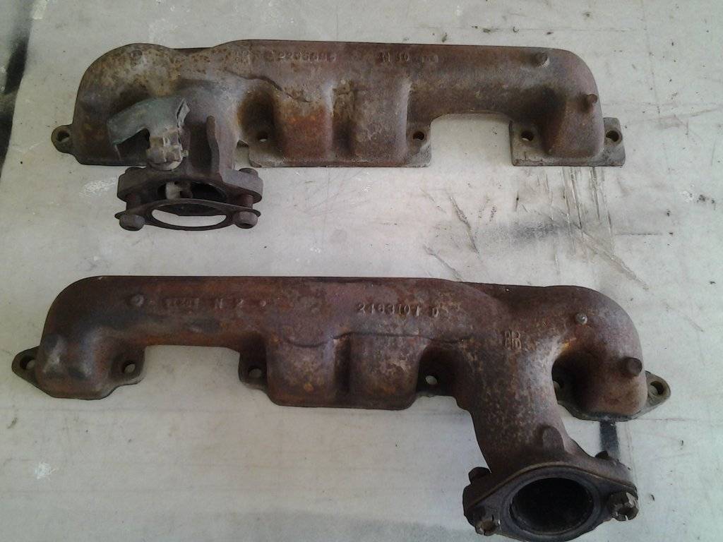

Right after I posted, the photos showed up. The ones in the first photo are the ones that you want to use. The other are the standard exhaust manifolds. If you had those in the car and a dual exhaust system, your head/manifold pipes will not be changed or modified.
Sorry about my uploading, new at this. The car is a 65 i dont have the orignal motor for it but i think those are the manifolds for it. The motor i,am putting in it is a 68 383 and those HP manifolds were on it.
The HP set all the way!:thumbsup:
