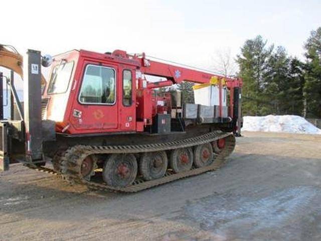

I'm thinking I heard somewhere that the 313 was also used for industrial/marine applications. When I was drilling we had a rig mounted on a track machine built by Bombardier the model was called "Muskeg Carrier" similar to this but no cab.
Yes. Chrysler of Canada built engines for industrial, marine and agricultural needs. Engines included the 303 (1956-57), 313 (1957-1964) then 318 V8 (starting 1965). Also had 251 flathead sixes and the slant six engines.
John Deere, Massey-Harris/Ferguson, Cockshutt, and others used Chrysler engines in tractors, combines, etc. Bombardier was one company that used them for various industrial uses.
