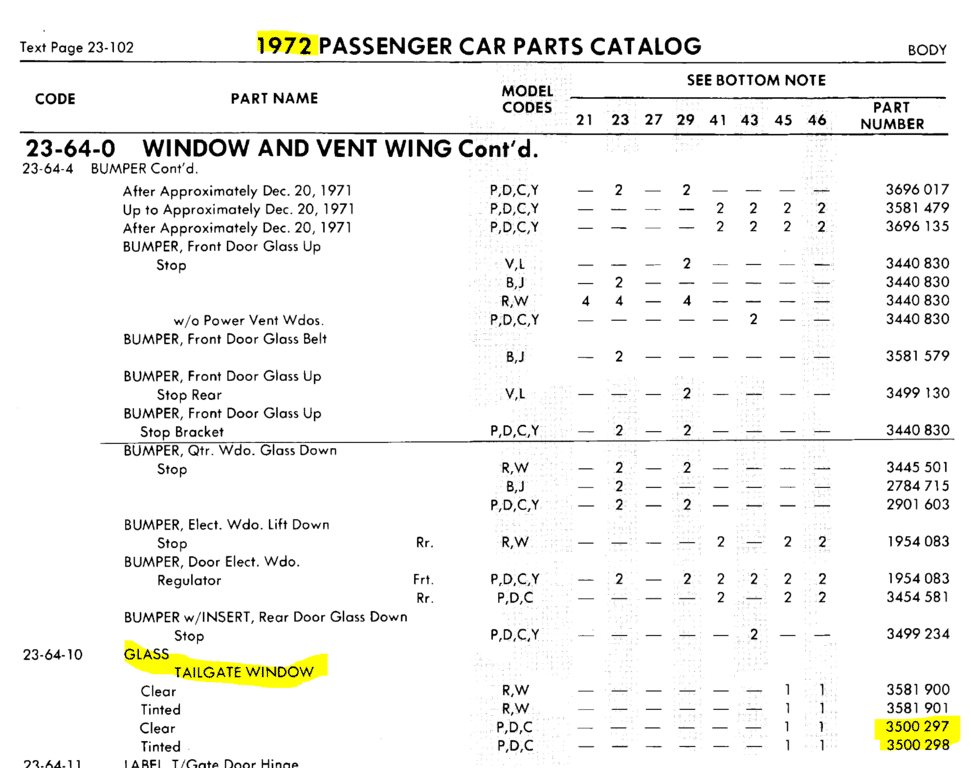

Update: Found the answer and buyed the tailgate glass. Thank you very much for your help! Isabel

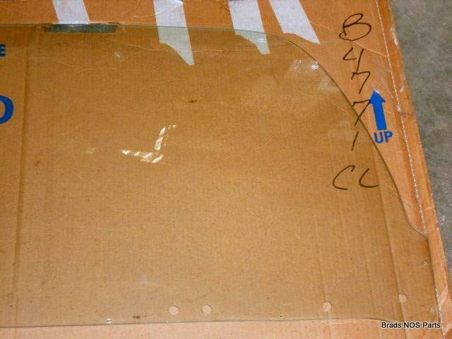

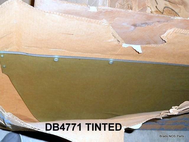

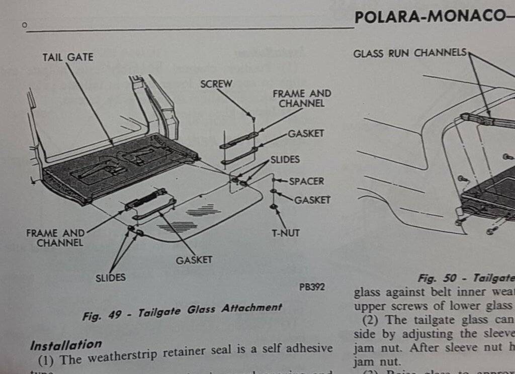

Hello together, I need help. My new 72 Monaco Station Wagon have NO Tailgate Glass. I can not take a look what one would be correct.
There is a glass, the seller write it fits 72 73 Plymouth Fury Suburbans and Chrysler T&C. Not sure about Dodge Wagons. I have a Body manual for 72 Monaco Polara and the picture shows other holes in the glass. Have someone a partnumber for the 72 Monaco tailgate glass?? As the seller have this NOS with number. It is not cheap so I must really be sure if it would fit or not. Your help would be appreciated. Thanks. Isabel Photos of the tinted and of the clear (same type) glass from the seller and a photo of my body manual.
