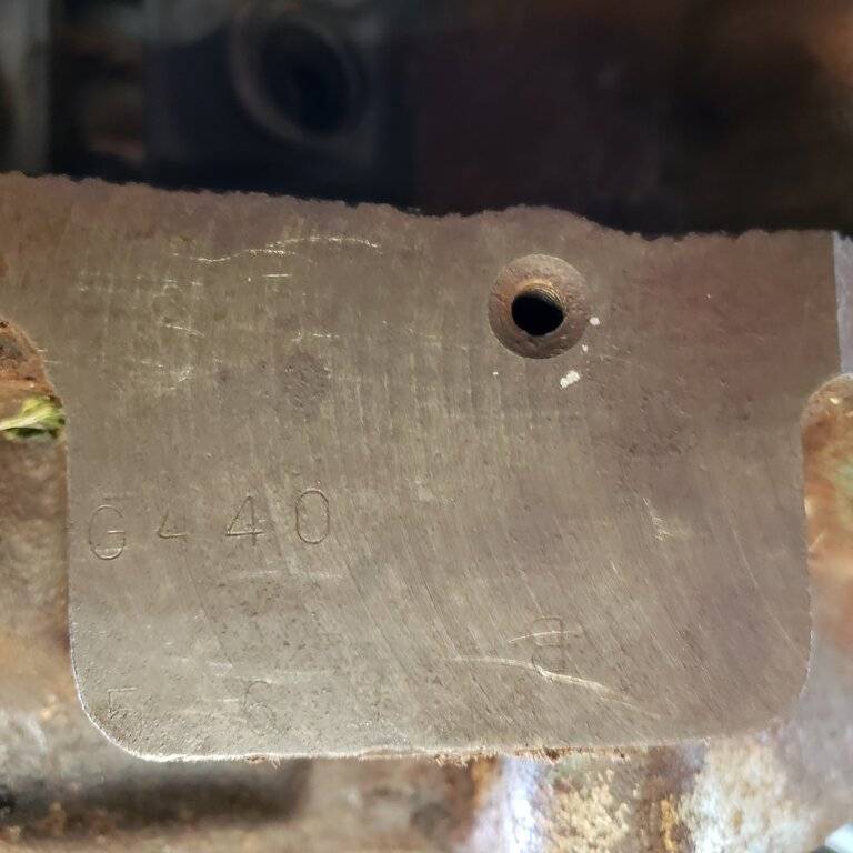

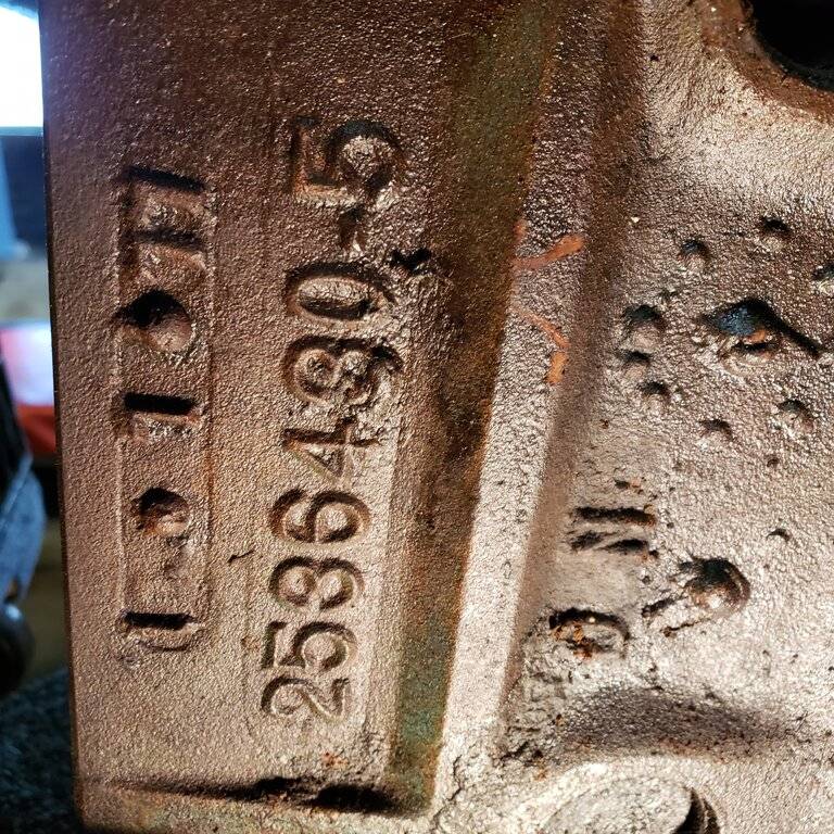

I have this 440 block with a casting date 1-7-77, however the casting number 2536430 is for 69-72? Also the pad is stamped with a G(1971). I believe it's a 71 with a wrong date cast in.
see pics
What do you guys think?

Strange. A 1977 cast block would have a different casting number and 440 cast right after it.
Counterfeit? Warranty?? Can't believe they would restamp a warranty block tho

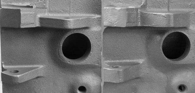

Check the width of the motor mount mounting ears, if it has the wider ears it is a '77 block.
