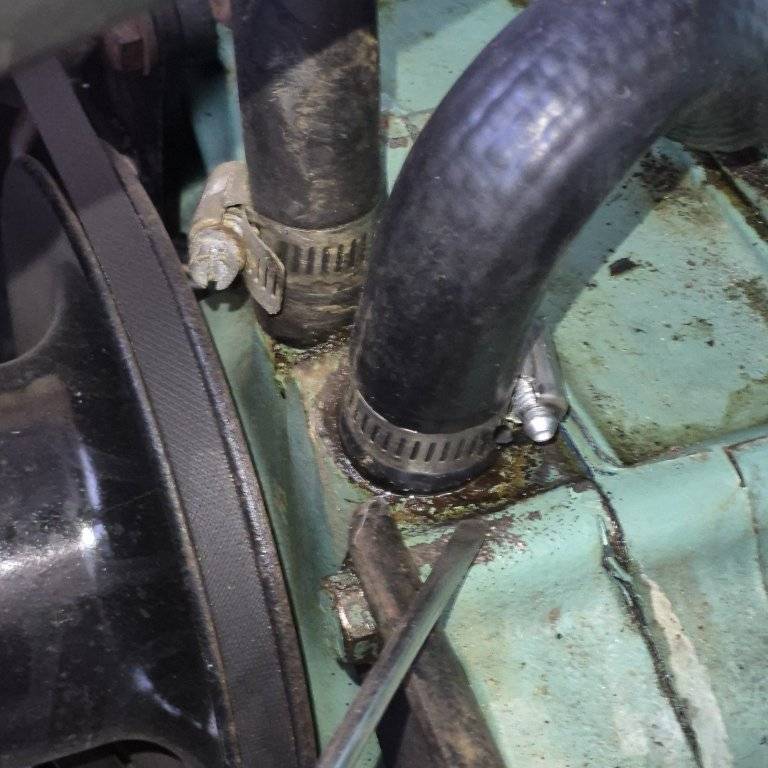

Unlike the 70- newer LA engines, Frankie's water puml and timing cover is different. Basically same parts carried over from the 318 Poly.
The issue is leaking at the nipple atop the water pump.
I thought it was the bypass hose.
New hose..still leaked.
Cleaned the rust and crudd off said nipple and cranked the hose clamp real tight
Still leaked.
Will try a new nipple for 10 bux but my gut tells me the water pump is corroded at the nipple.
Can a 70- newer pimp fit a 69 timing cover?
Thoughts?

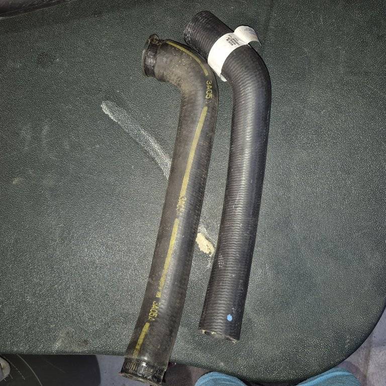

I had a spare bypass hose lying around but was for my 73 wagon.
I ordered and got the correct bypass hose locally for a paltry 18 bux.

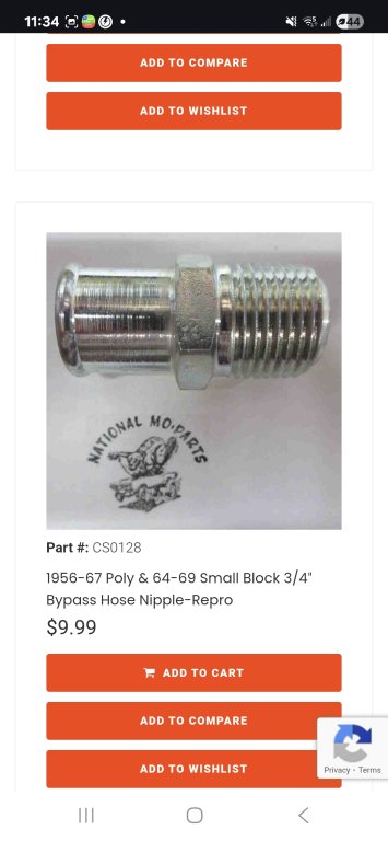

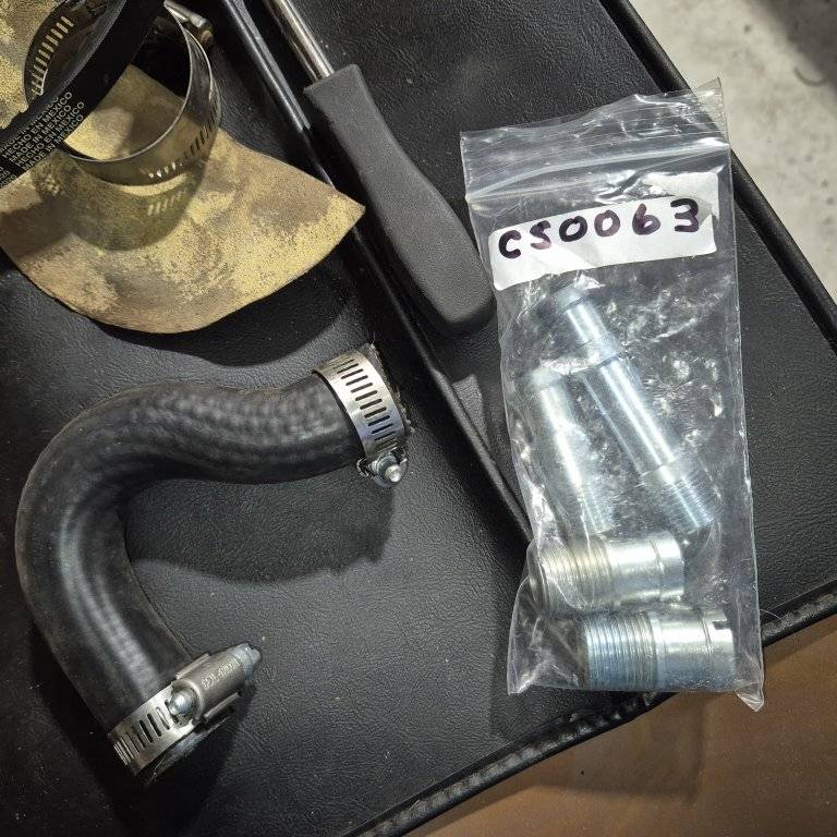

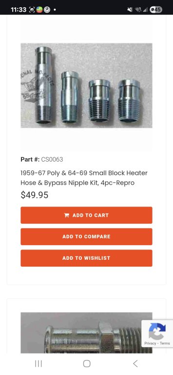

Got new nipples but the old ones said FU not coming out.

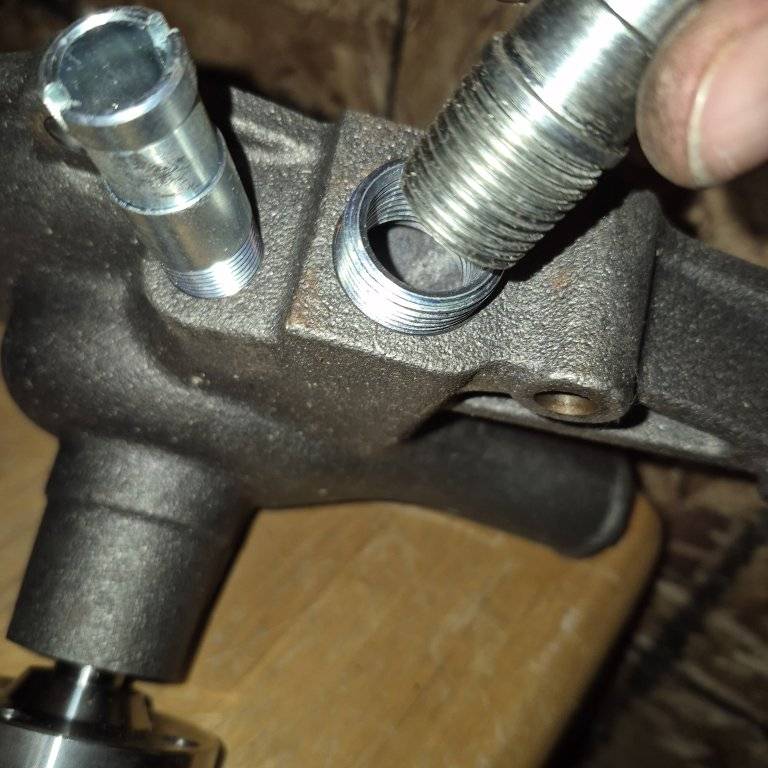

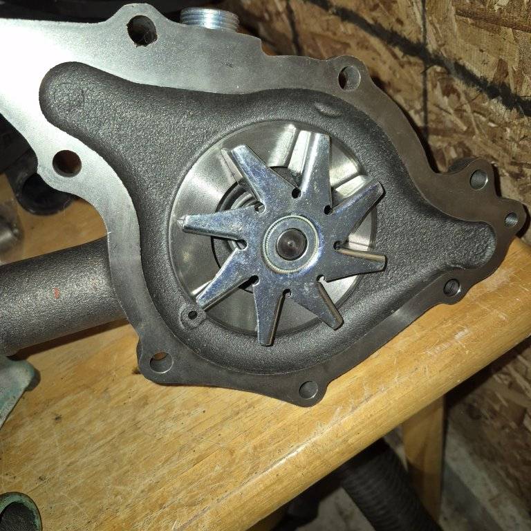

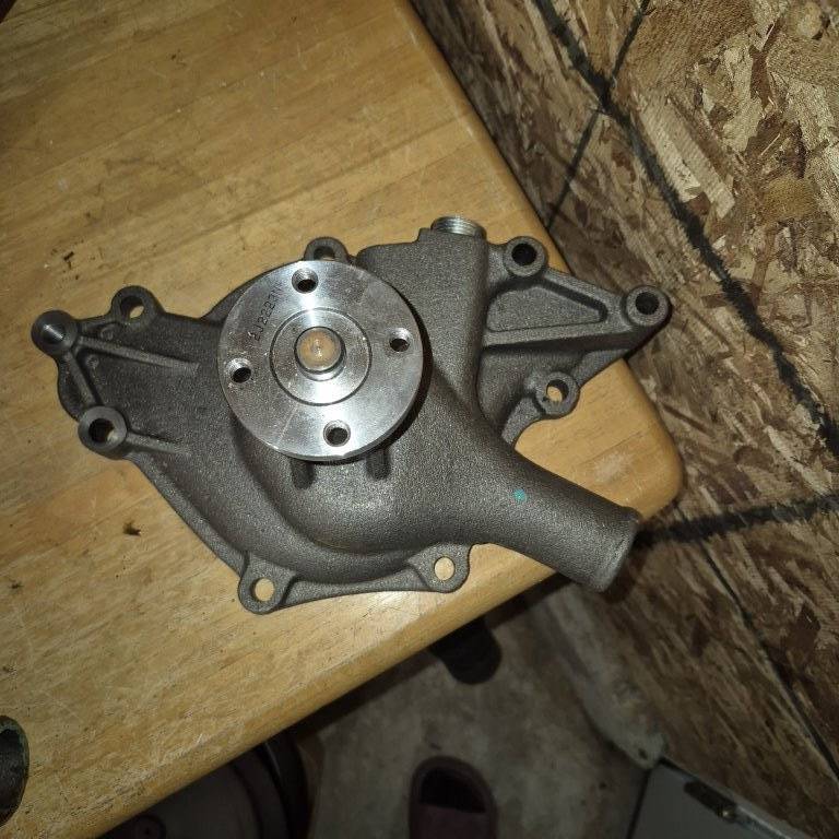

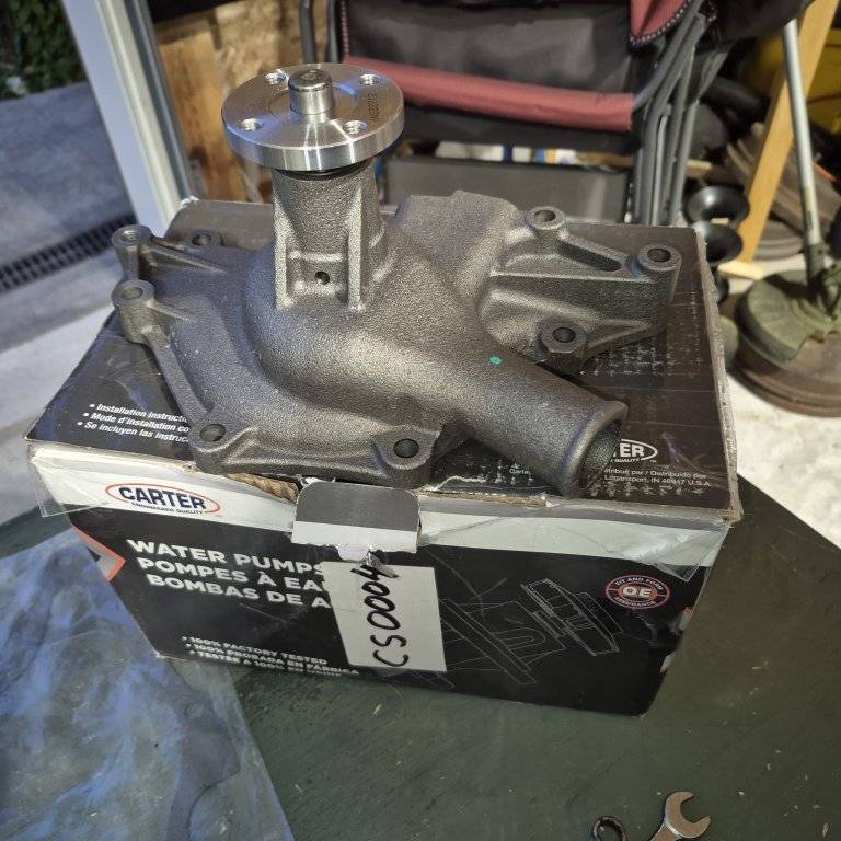

So I ordered a new pump and nipples from National Moparts.They had them in stock.
A Carter pump and at 94 bux it was cheaper than local parts jobbers even at my cost!
Removed the belts and drained the rad.
Spun the fan and the water pump had play and making noise so it was due.

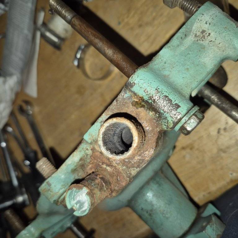

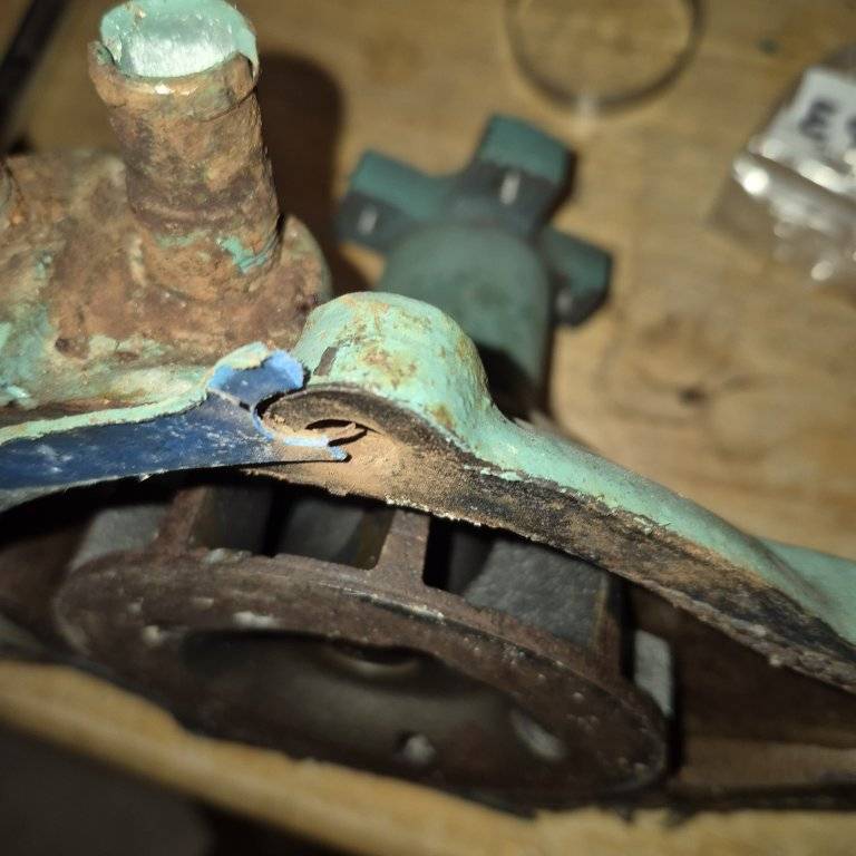

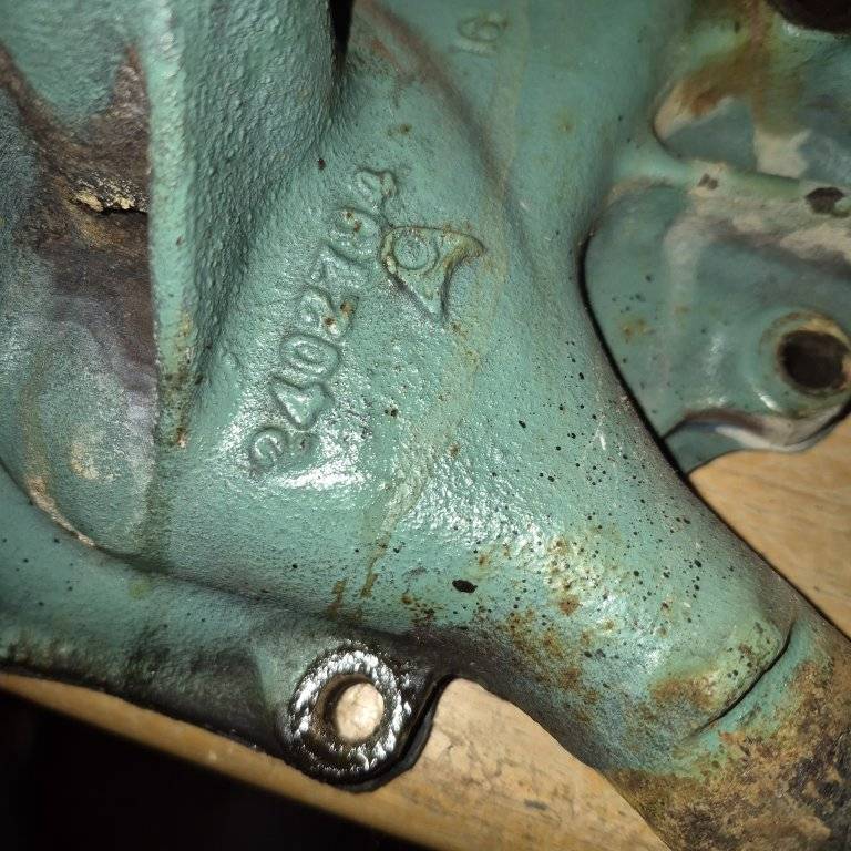

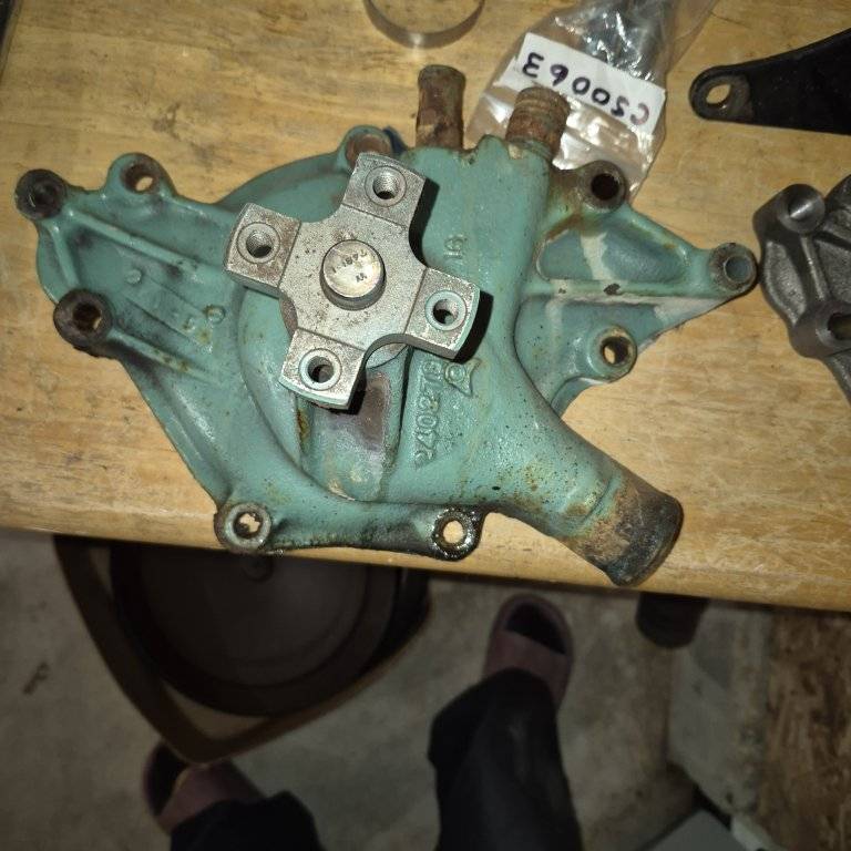

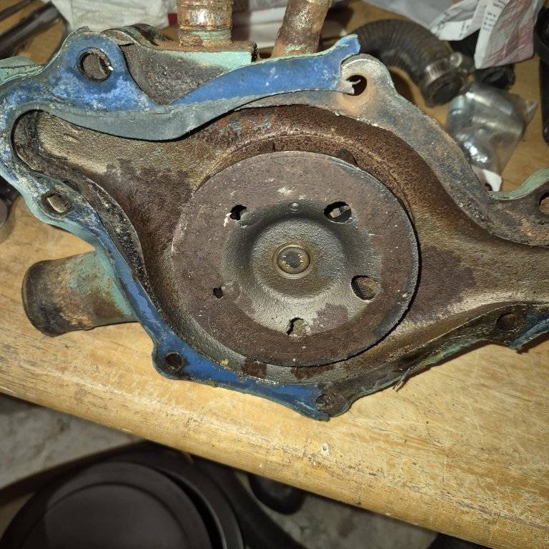

Pulled the old water pump off.
It appears to be very old or dare I say original

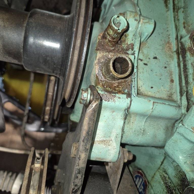

A refresher why I ended up replacing the pump.
The nipples were rusted badly and started to leak.
They were not coming out without damaging the pump.
69 last year for cast iron water pump passed down from the Poly engine days.

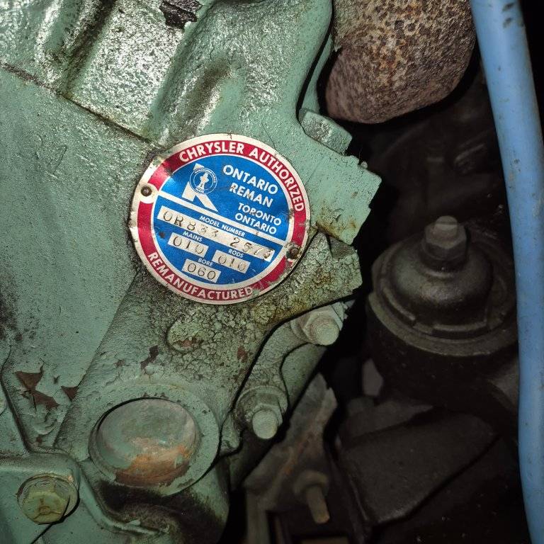

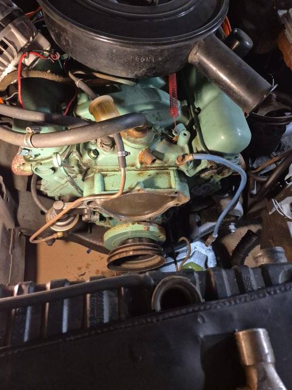

We knew when we bought Frankie that his engine was replaced sometime in the 80's by a Chrysler dealer.
With the power steering pump outa the way grabbed a good pic of the rebuild tag. .60 over!
Dont care, one of the best running 318's we have had.
Ignore the wrong color which was done by previous owner.
That freeze plug looks like it was leaking but coolant was running over it from the water pump.
Hope it dont leak..

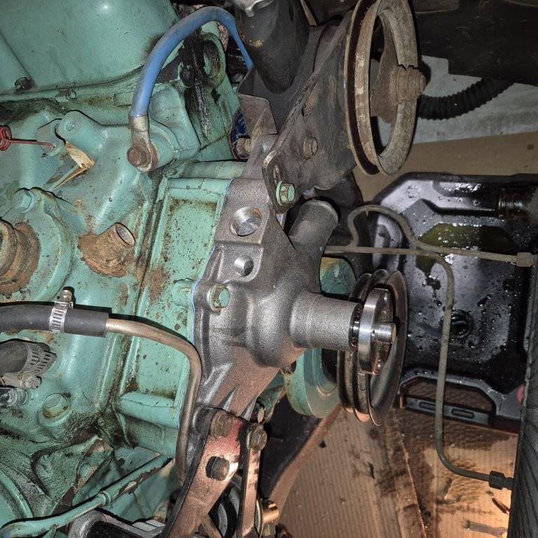

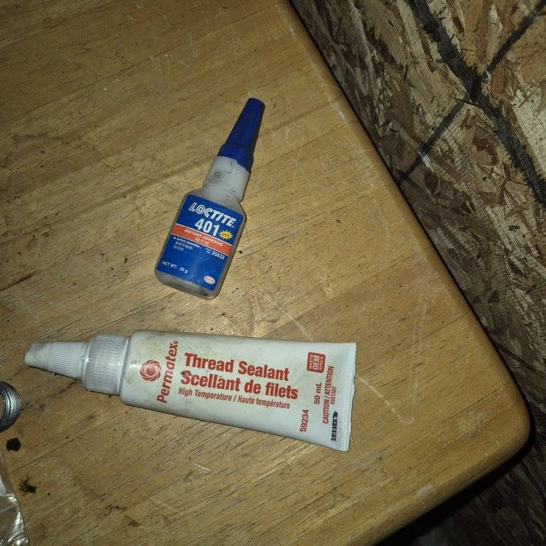

Used Loctite's version of crazy glue to position the gasket on the water pump.
Then cleaned all the wet bolts and used thread sealant.
Ran out of steam 1:20 AM so will finish up tomorrow and wake Frankie up.
Being a nice driver, did not bother painting the pump the wrong color,LOL!
