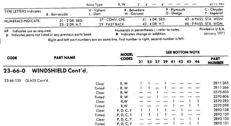

In looking at the Parts book it appears the 2-door sedan uses the same windshield as the hardtop and convertible.
Section 23-66-135
Alan
The 1969 and 1970 Fury I and II 2 door sedan used the 4 door hardtop roof and not the 4 door sedan roof as in previous years.

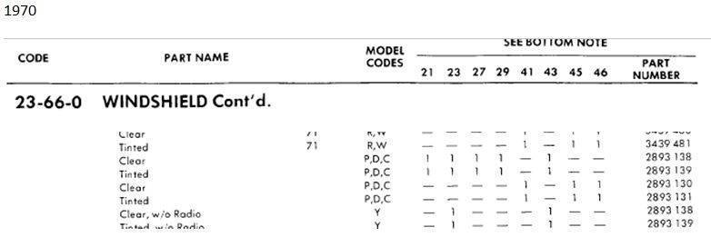

Hi, I apparently wasn't very clear in my first post but as you can see by the 69 and 70 parts books:
As you can see there are two windshields that were used.
Any 2-door windshield or 4-door hardtop windshield will swap out.
The 4-door sedan and wagons will swap out.
