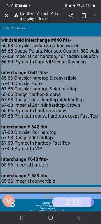

Just wondering what other C-bodies would be compatible with a windshield from a '67 Newport convertible.
Are the windshields for '67 interchangable? Regardless if 2-dr, 4-dr, convertible or station wagon? Or at least the 2-doors ?

Short version is that the convertible windshield is shared with the 4Dr HT (no B pillar) across P,D,C lines.
The 4Dr sedan (with B pillar) is shared with the 2Dr sedan and station wagon, again across all lines.
The 657 appears to be correct for your application.

2588883 tint, 2664428 clear. '65-8 C-body hardtop and convertible, except for the '67-8 Chrysler and Dodge 2dr HT, and the '67-8 Plymouth fast top and VIP. Sedans are different too.
