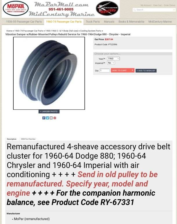

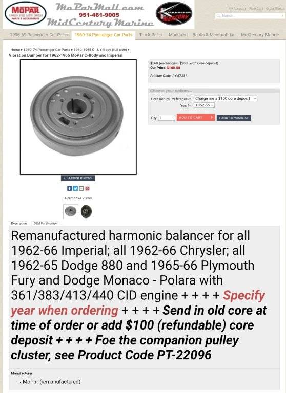

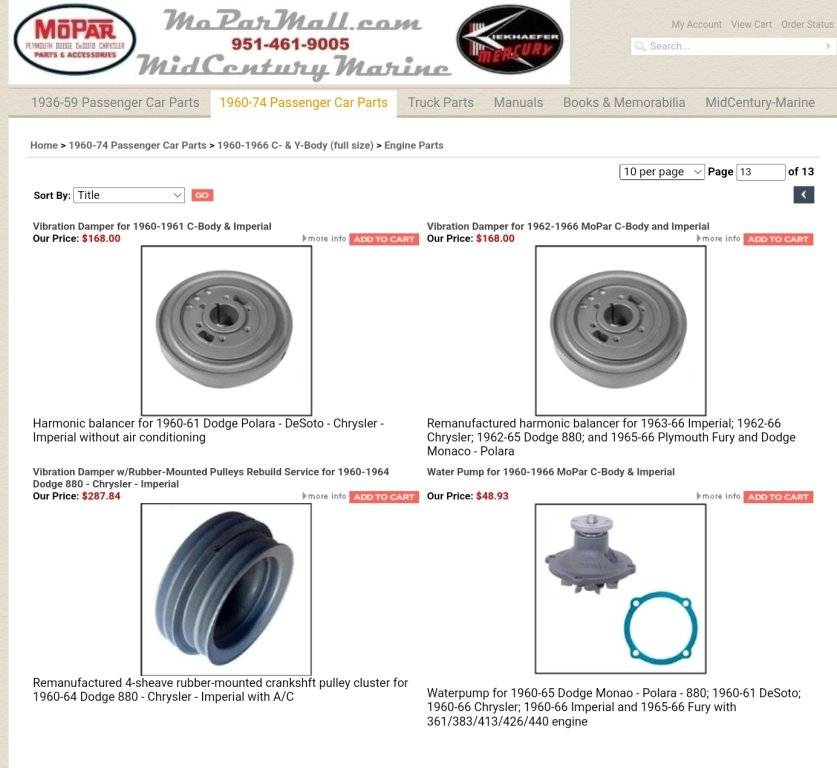

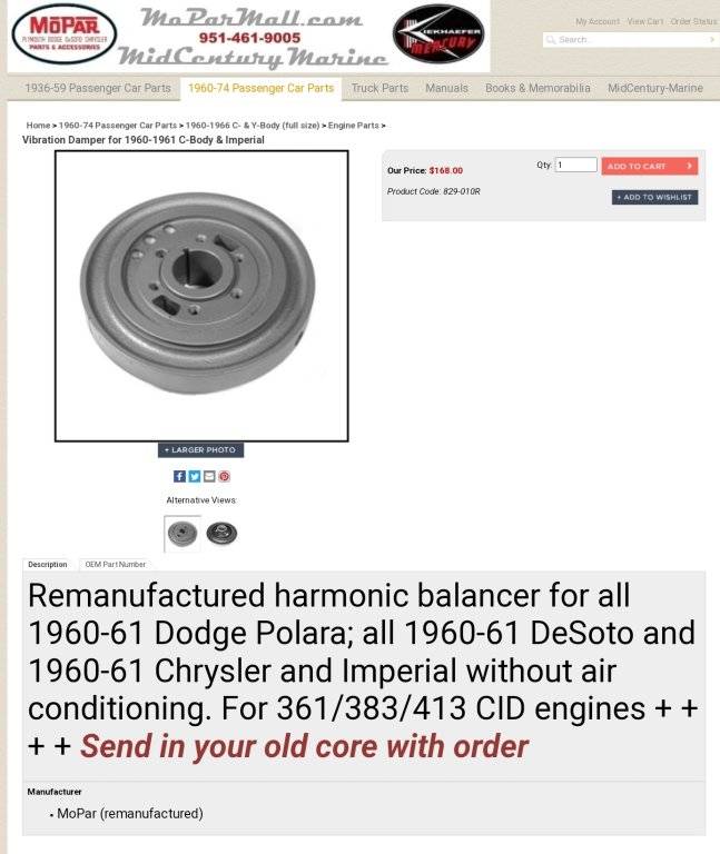

The other thing that threw me off was on Mopar Mall they have listings for two different harmonic balancers for Imperials and an ac crank pulley with rubber in it. I'll upload a photo of the listing.
