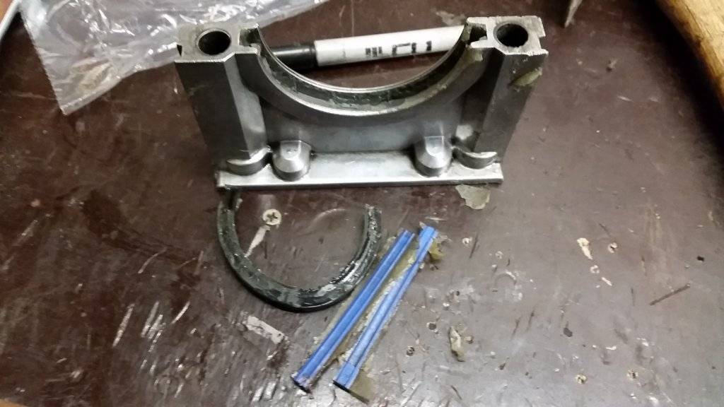

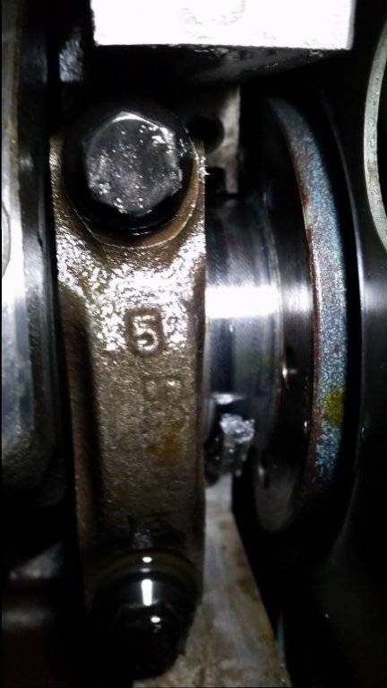

Any suggestions while I have the oil pan off while I replaced rear main seal? Just rebuilt it last fall, I retorqued the caps and journals, anything else?
Don't forget to offset the joints of the lip seal from the mating surface of the housing and use acetone or something to wipe the area clean of any oily residue before you rtv the mating surfaces of the housing to the block.
