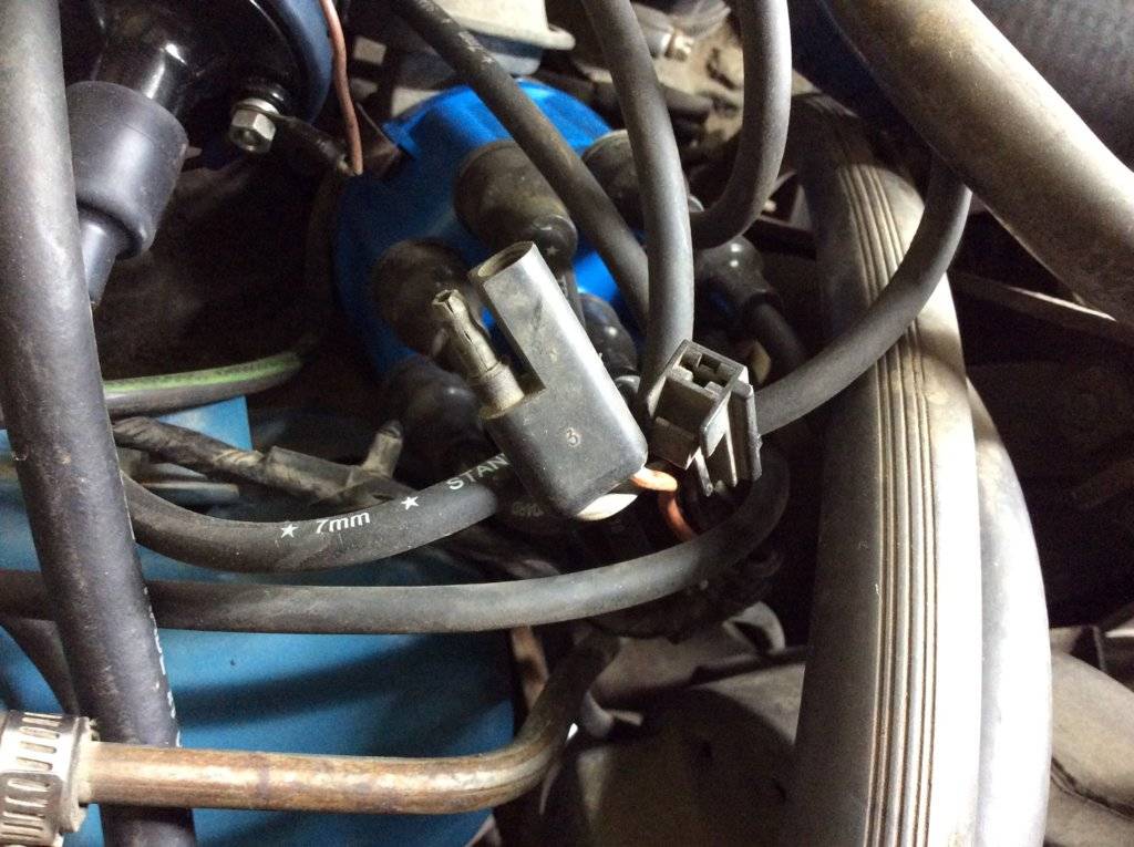

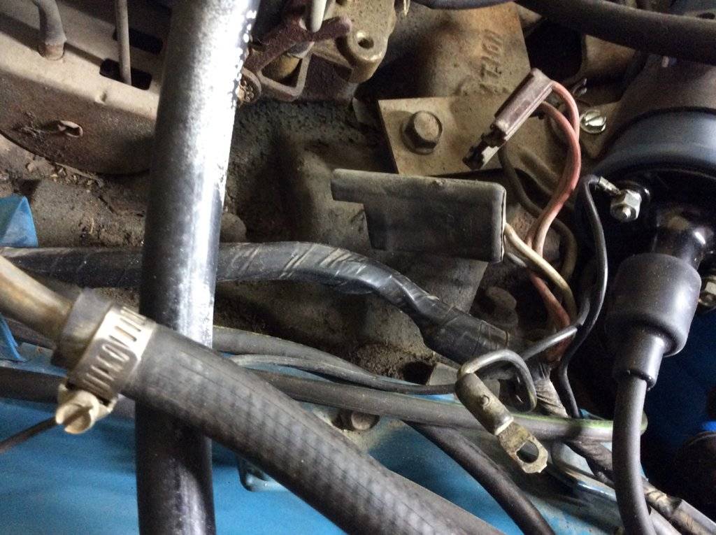

what does everyone do with the defunct Lean Burn ‘bay junk’?
I still have the LB unit bolted on to the air cleaner and all the wiring intact. I was thinking of leaving the air cleaner whole for nostalgia, but should I cut out the terminals from the wiring harness?

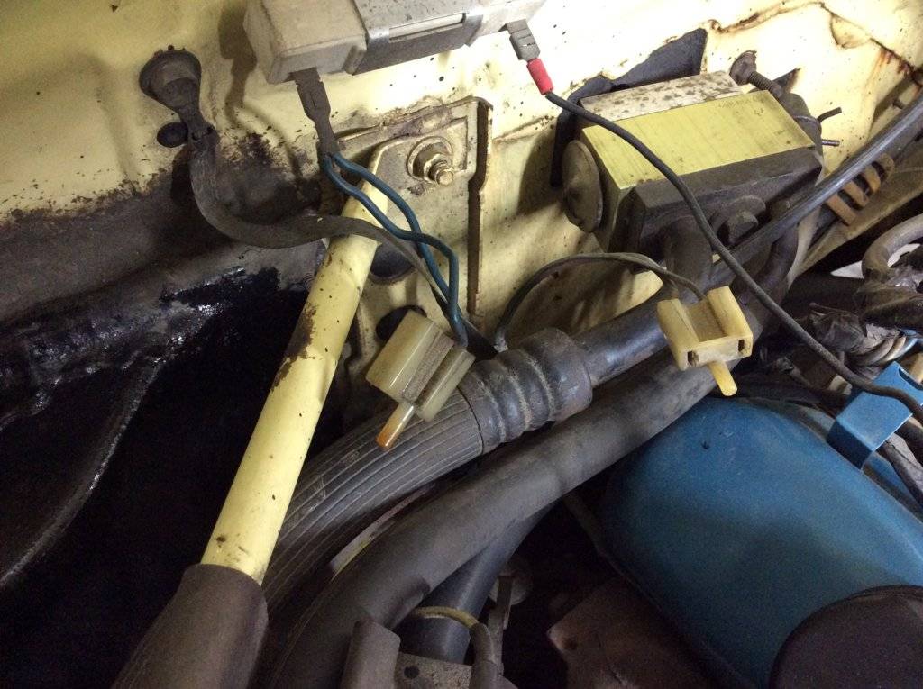

And while everything but the cruise control works, I got a pile of disconnected terminals everywhere...
Are they all related to the old LB?
Lean burn
Three
Behind the distributor
Two coming up from under and in front of the dizzy
And a pair coming off the ballast resistor...
How did you wire the "new stuff" in? Using an adapted factory harness or with something you fabricated for the new items? No common items in the harness?

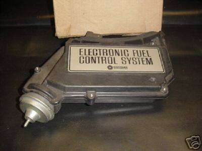

To remove all of the not-needed ELB items, you can get a service manual for the model year of your vehicle and peruse the wiring harness schematic "maps" to find what all went to the ELB computer, distributor, etc. and selectively remove it surgically. I suspect there should be one main harness it all relates to, from which everything branched off from.
Personally, I liked what I heard and saw at the dealership when the ELB system first came out. The engines were more throttle responsive and were quieter than the earlier model year's engines (at least in the Chryslers I saw back then). I was proud of Chrysler continuing its "calibration modification" orientation in emissions controls, as Ford and GM had to use "after-treatment devices", PLUS NO catalytic converters on the original ELB cars, which I considered a major feat.
It was my observation that as with a good bit of Chrysler's engineering innovations back then, electronic ignition being one of them, many techs didn't understand how things worked (compared to distributor weights, springs, and vacuum advances), so it was "bad" and another reason for the cars having to go back to the dealerships for service (which the independent shops didn't like, obviously), BUT it also related to many not desiring to learn new things, from my observations. Years later, when GM had electronic engine controls, all was fine.
I also know that as the systems aged, few knew how to really troubleshoot them. Chrysler had their "checker box" for the systems, which seemed to "Fail" many boxes whose failures could have been related to other things in the wiring harness itself. The whole system worked on voltage and resistance, which could also be affected by poor wiring connector integrity, by observation, or degraded ground connections.
Oldsmobile had a similar system that was optional on the later '70s large cars. A one year item due to low installation rates, but those who had one of those cars raved about how it got better fuel economy and such.
The Chrysler ELB helped get us into the '80s and the more advanced/sophisticated systems of the later years.
The key to the system was the leaner carburetor calibrations at cruise, which needed a different distributor advance map to make happen. Which was best done electronically than mechanically. By 1980, the "lean burn" part was gone, leaving the Electronic Spark Control system.
The problems I saw with "Conversions" were that many got an aftermarket electronic ignition system (hopefully the Mopar Perf full kit), went to the auto supply and got a reman TQuad (whose metering calibrations were not usually a good match), replaced components and TRIED to get it to run right after that. Not performing as desired, the cars were sold CHEAP and fell into hands that ended up trashing them instead of spending money to see what the prior owner had screwed up in the conversion. And things went downhill from there, by observation.
To me, back-dating to about 1972 specs should have worked better. I suspect the shops that did these things had little ideas of how to better match what they installed to the engines. It always was interesting to see how private shops talked bad about the Chrysler "electronics" systems, but when GM came out with very similar things a few years later (possibly with higher quality wiring harnesses AND better training), it was "all right". After all, if General Motors does it, it has to be good?

I didn’t replace anything. Just found I all sitting here. This was converted a long time ago. I’m just thinking of what I can clean up. Maybe I’ll just tie them up with some zips and leave them tucked in there.
I think my new module is what I tripped over on the inner fender.

There was a lot of extra wiring with the lean burn package. If you someday plan to put the car back stock, you would probably want to leave that stuff in place as rewiring the car to reinstall the lean burn would be a major PIA at some later date. I would do as suggested and fold up and zip tie the existing wiring to preserve it. Probably a good idea to tape up the ends of the connectors while you are at it. This won't be as clean looking as removing all of the unused wiring, but at least it is still there for a future factory correct restoration by you or a subsequent owner.

I think that is the logical choice. What I haven’t heard is ‘everyone just cuts it off and seals it up’.
I doubt this will ever go stock, but who knows. I will let the next owner decide in 20 yrs.

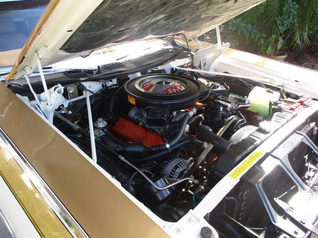

Forgot to comment on my wiring. When I did the wagon, the whole wiring harness was removed, tested, and repaired/ rewrapped as needed. During that process I removed all of the LB connections, so my harness is essentially 74-76 non LB spec. I am using the 4 pin ballast resistor set up from a 75 parts car ( I see your connectors are dangling) I used the distributor connectors from my original harness (those seem to be redundant and unconnected on your yours?).
I was not hard to do, and I have no intention of ever trying to Frankenstien a working LB setup again since the old Electronic Ignition is what I'm used to and "stone-axe reliable". Although I really respect those that have got their LB set ups back to working condition.
I have my wagon really dialled in and averaged 18.9 mpg on the last road trip.
I just left this air cleaner / pie tin/ computer alone to retain the stock look. Besides, they always look terrible with riveted/ screwed on metal patches to cover the computer vents.

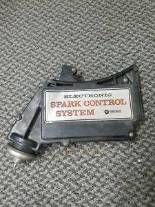

Interesting note, is that I've seen different types of computer decals over the years others said "SPARK CONTROL COMPUTER" or "COMBUSTION COMPUTER" then the "ELECTRONIC FUEL CONTROL SYSTEM" 80's version.
But the only one being re-popped in the "SPARK CONTROL SYSTEM" decal.
