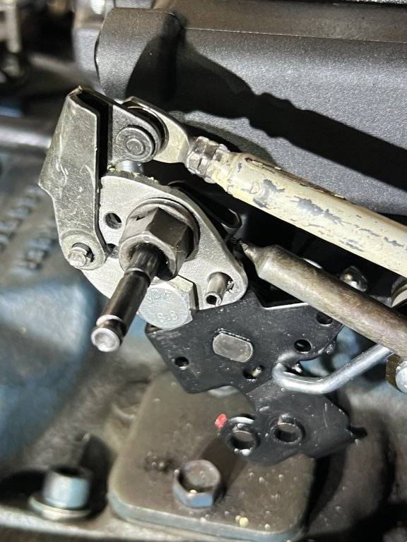

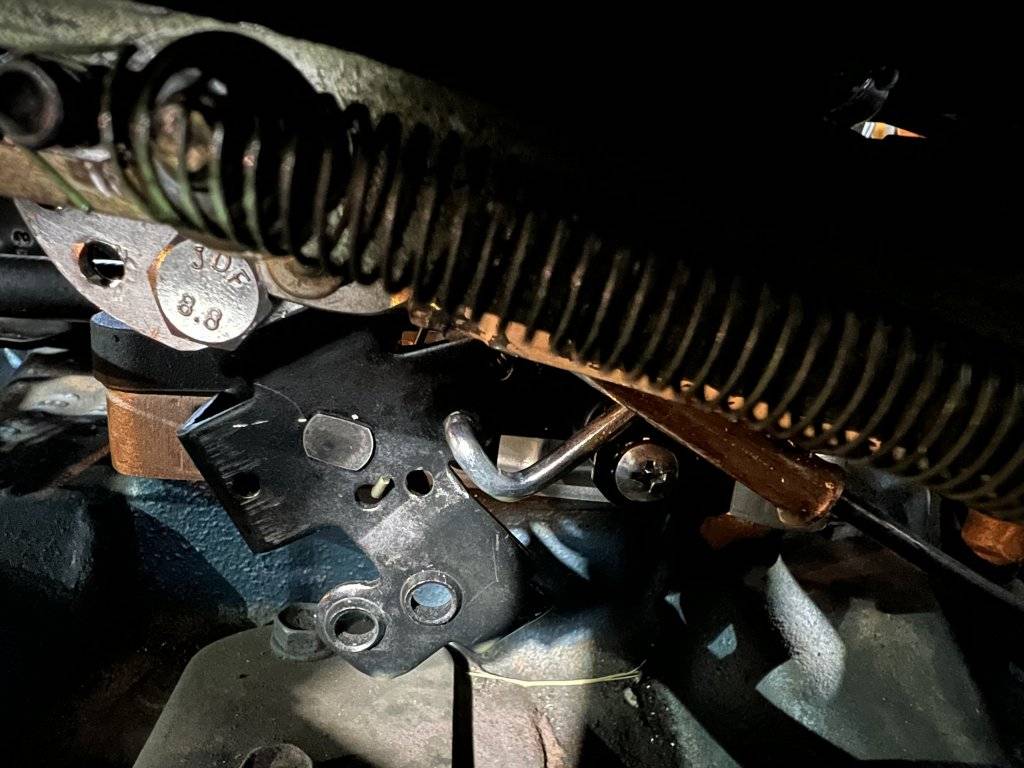

Todays project: stagger the throttles so as to open in steps.
The sniper comes with two holes for connecting the front two barrels with the rear two linkage.
Took out the linkage and bent it so as to work the rear throttles after 1/2 way point of the front pair. Like a mechanical secondary.
Took about 1/2 hour after install for the computer to relearn what was happening and adjust itself to a more progressive amount of air. Needed to adjust the initial throttle setting up a bit to get the idle air control to work at around 11%. Monitor provided with Sniper is an invaluable tool.
Here’s a picture of the “adjusted” linkage.
Here’s the original set up as it went in.
Here’s a detail of the linkage
The original style linkage (silver link below throttle cable and cruise cable) set up shown above did not work with the air cleaner and cruise control in place due to interference. This link was just bent to 90 degrees at the same bend point and moved to the next hole up.
Cruise control was moved to the outboard end of the alignment pressed pin. It works fine now.
Next project: clean up the adapter plate where the original throttle and cruise control are connected….. now that it actually works.

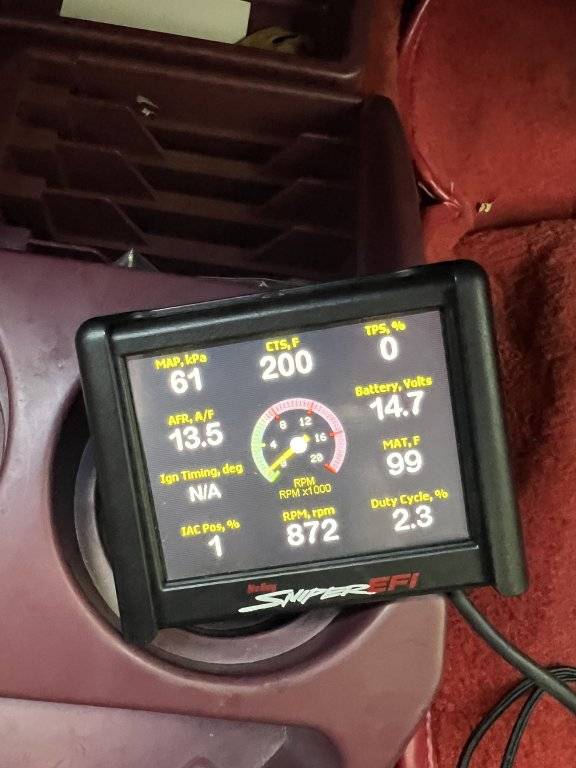

Here’s the latest readings from the sniper control box:
MAP, kPa is: Mass Airflow pressure
CTS is: Coolant Temp Sensor, 200 is about average after warmup
TPS is: Thottle Position Sensor, idle no throttle is 0
AFR is: Air/fuel ratio. 13.5 to 1 is a little rich but less and it has more to make up of line and tip in of throttle suffers a bit.
Battery/Volts is: self explanatory
Ign Timing is: ignition timing… next upgrade.
MAT.F is Mass Air Temp in degrees F. 99 is a lot cooler than engine compartment air due to outside air ducts. Before ducts it was a source of pinging problems.
IAC pos % is Idle Air Control position as a percentage of available idle air which can be added. Sniper literature says to tune it to 11 at idle.
RPM… do I have to say it?

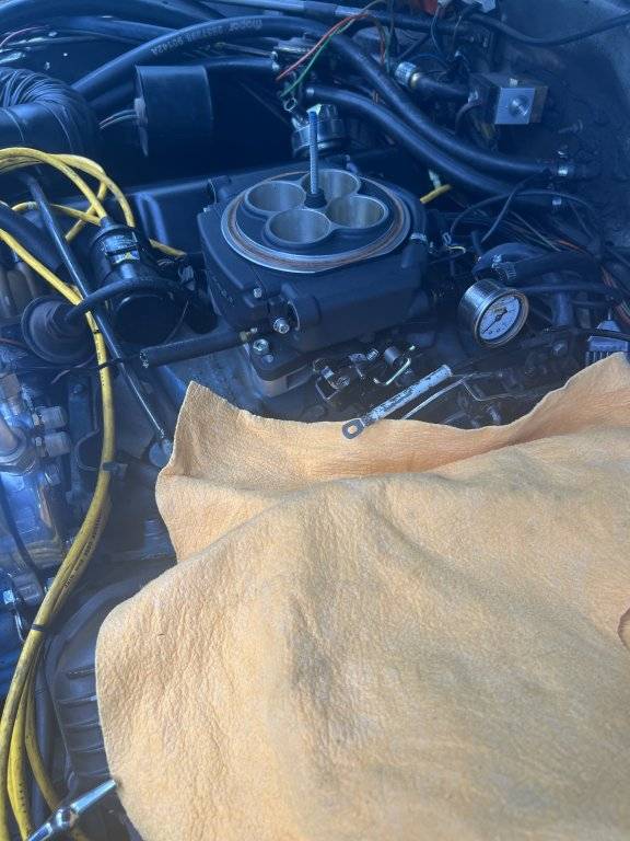

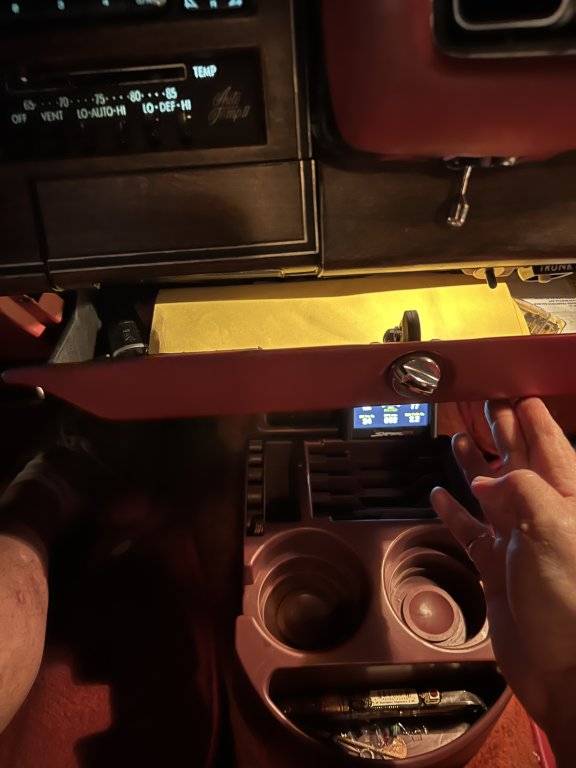

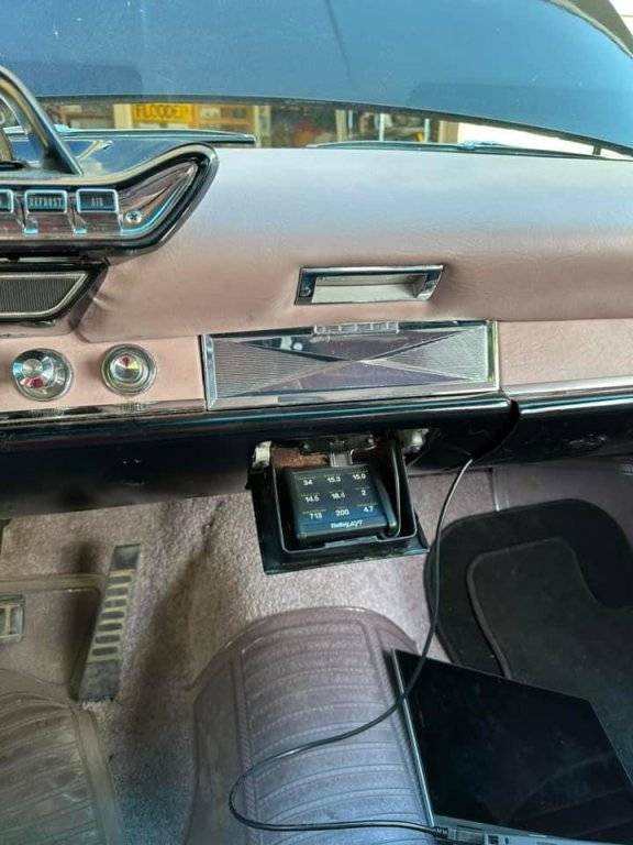

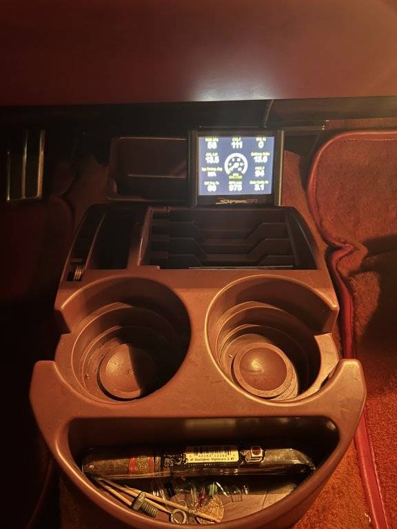

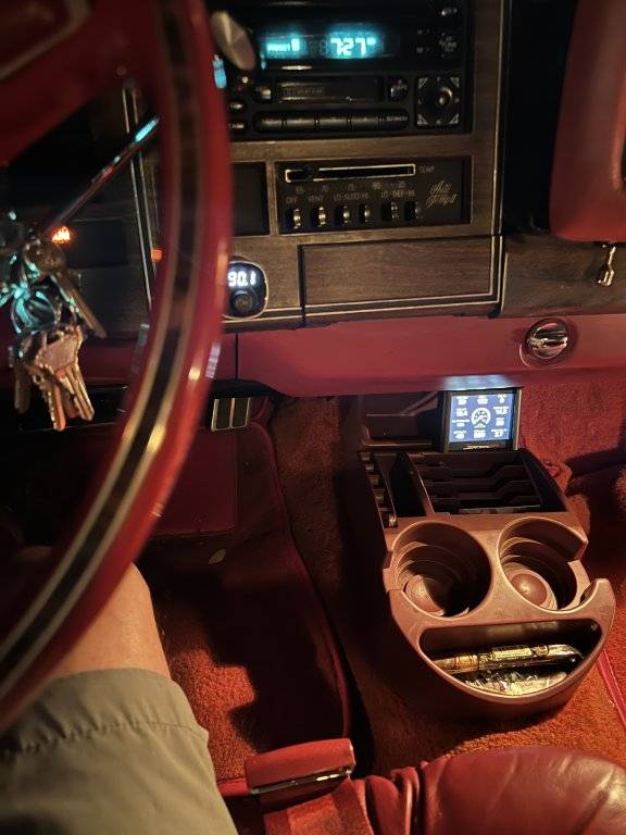

Monitor found a home:
After having it the glove box, I didn’t like that I had to open it to see the monitor and then remember to close it to avoid the drain on the battery.
So I propped it up between the A/C vent under the glove box and my aftermarket cup holder
And the glove box door opens without interference.
It also has the added benefit of stabilizing the cup holder…. Which is also very good.
