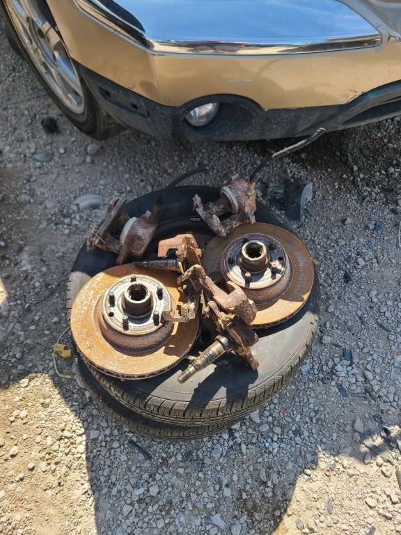

It will work but you need to get it all. The disc assemblies from both sides, The proportioning valve, The booster, Master cylinder and Brake pedal hardware under the dash. You will probably find the booster and master cylinder will need rebuild and the calipers possibly rebuilt and new pads and hoses. Good luck with your upgrade.
yes you can bolt those spindles on to your lower ball joints or use the junk ones, whichever are in better shape as they are both the same...if you're converting from manual to power you'll need booster and pedal assy...if they are there grab everything...I converted my 68 fury to discs over 20 years ago and left the original Midland single diaphram booster and prop valve and it stops just fine cause I didn't have the internet to tell me it wouldn't
Well one almost heat stroke and a massive sunburn later.
I got what I could

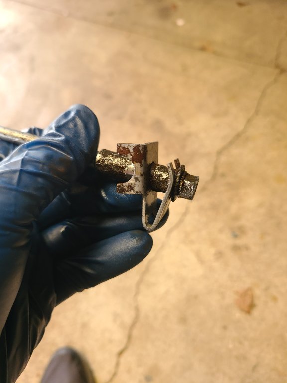

I need new lower ball joint bolts. What has everyone done? Cause I am kinda hitting a road block on my end
can anyone help me here. I don't know the name of this clip and if it's possible to get new ones.
