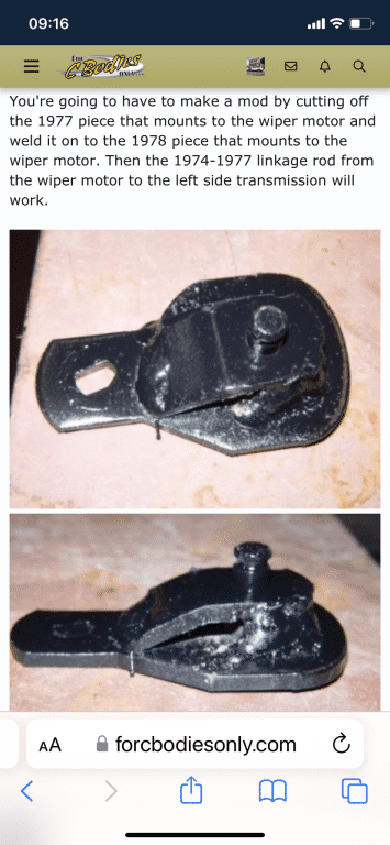

Hello,
Anyone know where I can find this plastic piece that goes to 1978 Chrysler New Yorker? Motor works but found this piece broken inside
Try Mars or Saturn cause they don’t exist on our planet.. lol, but seriously! VERY common problem on 78’s.. Do a search of the forums and you find all you need to replace that Cam. Will involve some fab work but it can be done.

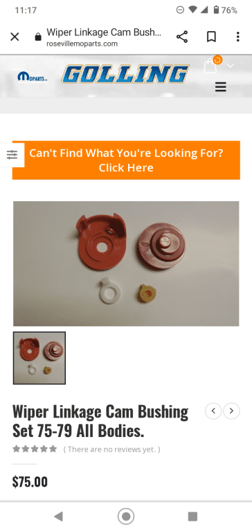

Wiper motor pivot bushing. The help products used make them but find a OEM mopar one and grease where the ball linkage goes into! Ocassionally you can find them in the Mopar rebuild kits. Get a part number of a IPB. Tommy at parts hound might have one.
Do you have contact info?
That looks like it should work, grease the hell out of it when you put it in.
That's new. Never seen that offered before.
What bothers me is the description, All bodies, 75-79.
They are going to get 90% of them returned.
I'll be extremely interested in knowing it is a 78 c body bushing.
