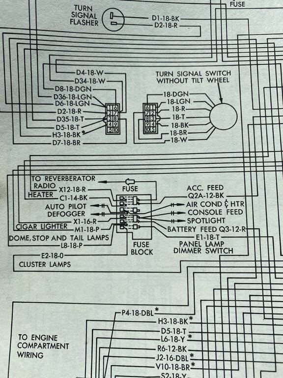

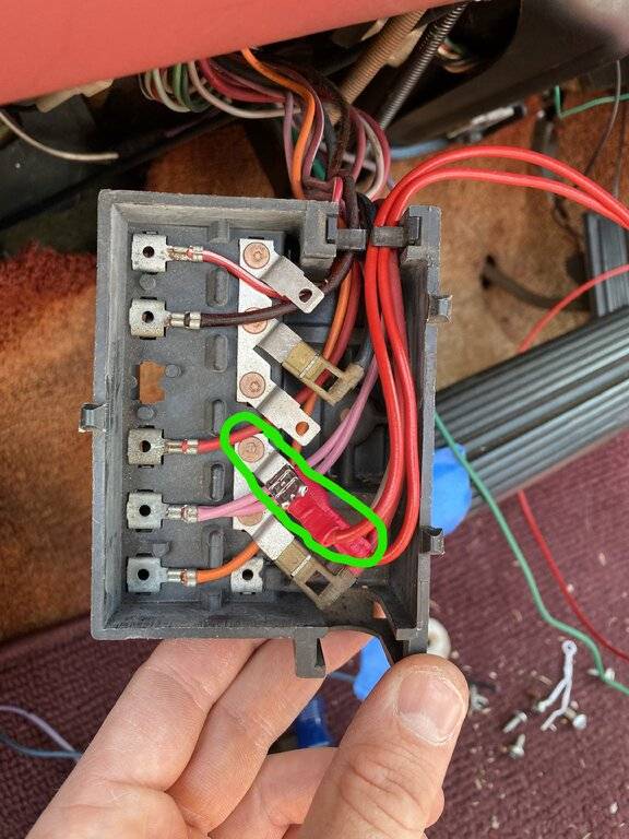

Did a test run of wiring the gauges and toggle switch yesterday. I used a piggyback spade connection on the terminal labeled in the manual as, "Spotlight/Console feed" (It was empty). Is this a connection that would be an "Accessory: Hot only when the key is in the Run or Accessory position."
