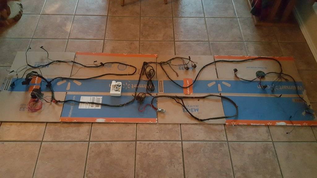

  7. MrMoparCHP
    MrMoparCHP Senior Member
    Messages:
    4,286
    Likes Received:
    2335
    Joined:
    Aug 9, 2013
    Location:
    Lompoc, CA
    • Thanks! Thanks! x 1

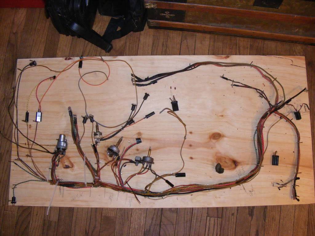

  8. 67Monaco
    67Monaco Old Man with a Hat
    Messages:
    5,611
    Likes Received:
    2625
    Joined:
    Nov 20, 2010
    Location:
    Punta Gorda FL
