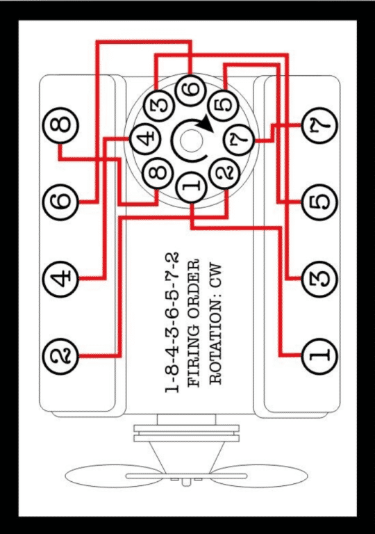

318 Poly has Clockwise distributor location.

He said he is not getting spark to the plugs. If he has the firing order off it should still have spark, just to the wrong cylinders.
