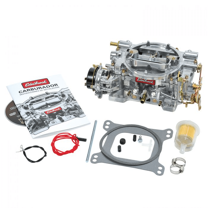

I had an Edelbrock carb do the same thing years ago.
I think I had to remove the linkage rod between the choke valve at the top left side of the carb and the throttle linkage below in order for it to stop. Never figured out why the car did that.
Edelbrock 1406

Thanks. Since removing that little rod takes 2 minutes, I'm going to try that first before trying to crawl underneath the car with my old carcass. When you say "left side", you are referring to the driver's side or left side of the carb when you are looking at it under the hood?
This car indeed has cable linkage, not rods and levers on the firewall.
I forgot to mention that this cable has the nasty habit of shifting in the mount, no matter how tight I screw it down. The cable moves freely in the sleeve, like a hot knife in butter. However, after fixing it, it will shift in the mount again on the next drive around town resulting in higher idle rpm. Maybe these 2 issues are related?

Left side is driver side. I'm trying to remember something from 20 years ago. It was either that choke pull-off rod that caused the problem or I had to disconnect the fast idle linkage. Does your car have a fast idle screw?
If the accelerator cable sheath is shifting forward and backward, I think it is contributing to the problem. Side to side may not be a concern as far as fixing the high rev issue.
