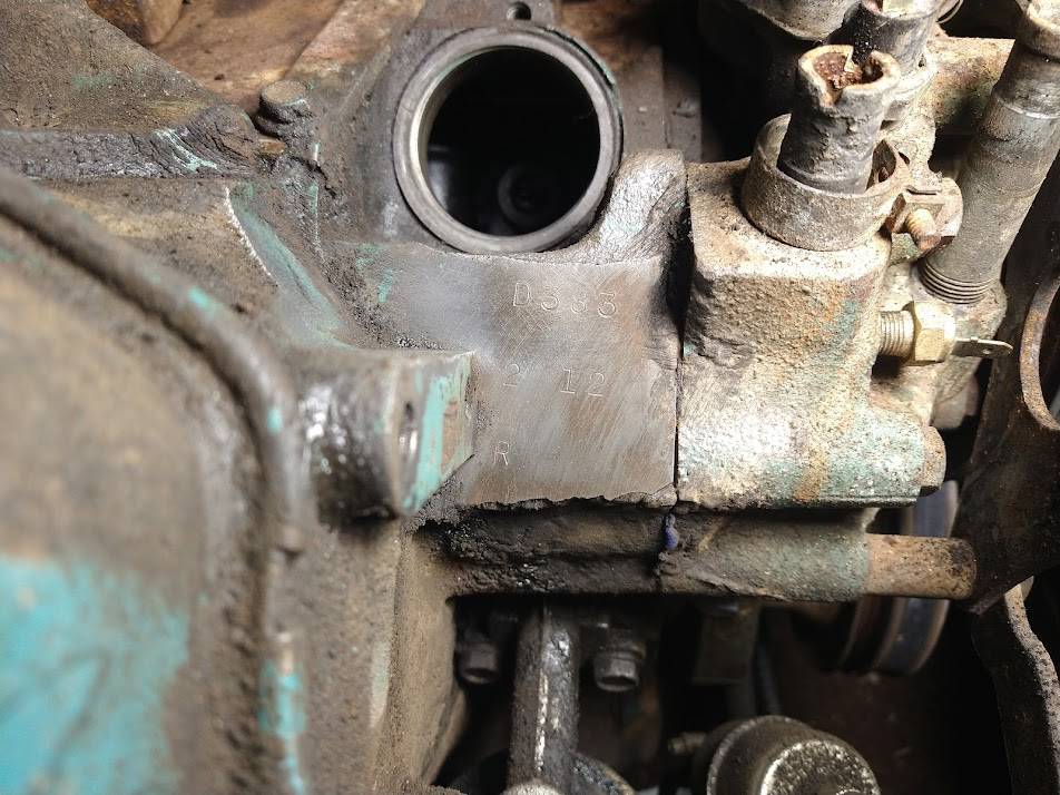

I managed first to uncover the engine boss, and the numbers typical of a 1968 383, thus confirming my suspicion that this IS THE ORIGINAL ENGINE TO THIS CAR! It goes with the radiator, which also is a 1968 radiator. Ecce:
D383
2 12
R
Yep, its a 1968 engine.

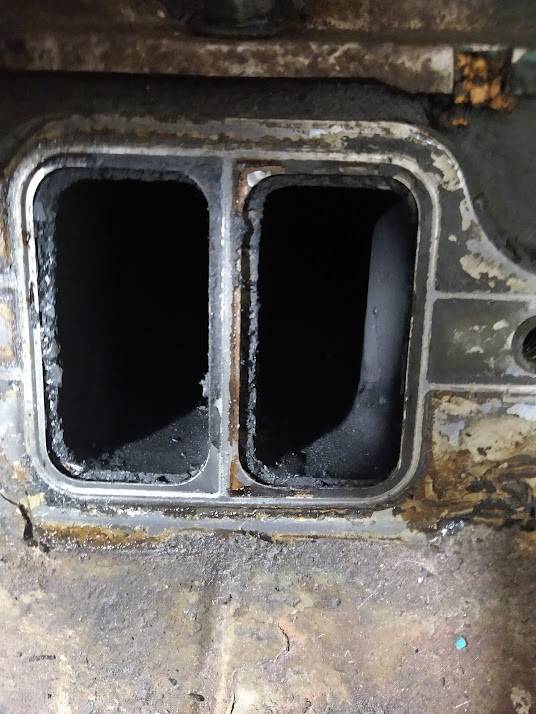

I predicted the next condition to Tamara, my Balkan Bride, before removing the intake manifold:
Hoooly RATSHIT Ratman! I based my predition on the ugly trick played by my air compressor, when I blasted into the crossover port and got bombarded by rat feces from the other side. Oh these barn finds are FULL of FUN! I had noticed small tufts of fiberglass insulation earlier, when installing the oil pressure gauge. So, after the bombardment, I predicted what in fact proved to be exactly the case visible above/ ONE Pleasant surprise though; that valley pan turned out not to have any corrosion holes. I thank the Lord for my blessings. Look at the crossover port on the bottom side of this pic. Nasty buildup there, eh?

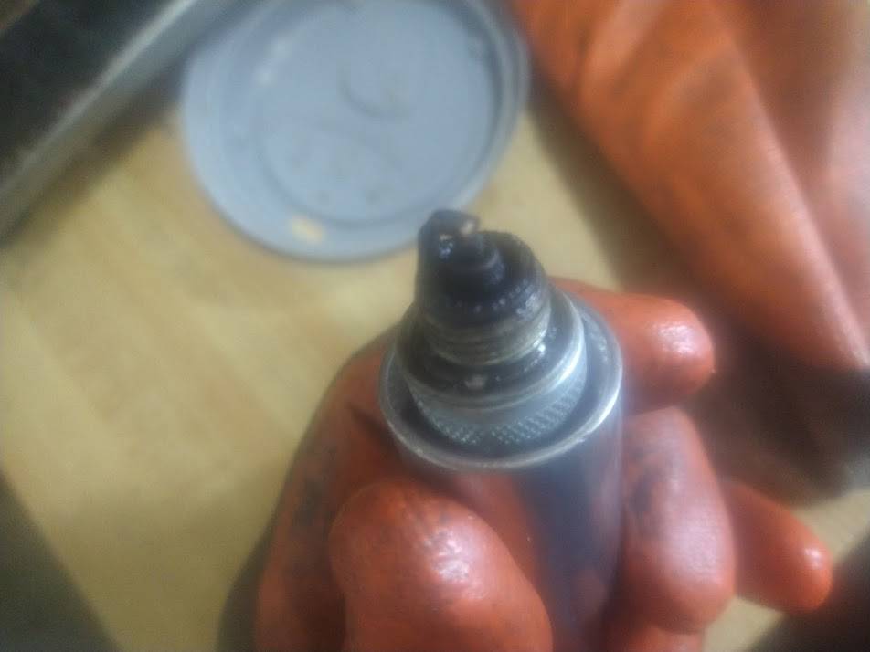

All the intake ports show some carbon fouling, indicative of backfiring. The two worst are on cylinders 4 and 6. Surprise surprise SURPRISE! That's about where I read the highest block temperatures a few days back. Reckon those 53 yr old steel shim gaskets may have rusted to powder, allowing crossover detonation? I wot it might just be so. Nasty lookin, ain't they?

I had to remove the two middle spark plugs to get at the exhaust manifold bolts too. AGAIN, Cylinder #4 shows FOULING.
My suspicions regarding this cylinder coagulate. We Shall See Soon...

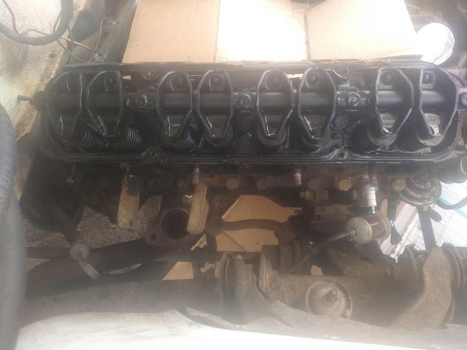

So, NOW we can see the cylinder head. It looks GOOD!
Damned pretty for an original. I start suspecting that this is a reman head. Of course, its a 906, which is Correct for 1968. Given its condition, and how WELL the motor runs, excepting only this runaway overheating, I've no other complaints.

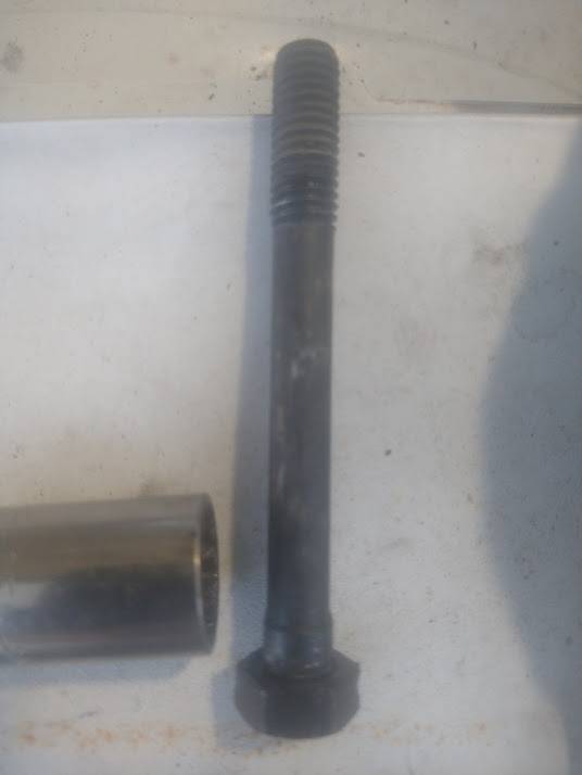

Now, off with the rocker arm assembly. Then, the head bolts. MORE Interesting Details:

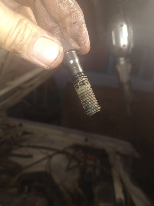

This is bolt 17, from the very back of the head, up top. Note the apparent lack of any lubricant on the threads. This one appeared to be put in DRY! Hmmm. It sure as **** required more than 50 ft-lbs torque to break it loose. BUT after the outer 4 bolts, 2 in back, and 2 up front, THEY GET ABSURDLY LOOSE!!!! NO WONDER THINGS ARE GETTING HOT! The inner bolts came loose with VERY MINIMAL EFFORT! Most made a very non-committal, quiet click on the 50-ft# setting, but nearly half didn't even do that. These bolts had loosened over time.
This last pic tells the Real Story more eloquently than the rest, though almost all of them had SOME of this yellowish residue on them, whether the smooth shafts, or the threads, or both. This is the number 4 bolt, near the center of the head. I suspect this yellowish residue is OLD, DRIED COSMOLINE! If somebody KNOWS I'm WRONG, PLEASE ENLIGHTEN ME AS TO WHAT THIS SUBSTANCE ACTUALLY IS! Could this be Lubriplate? I know its mentioned a lot in my 1966 FSM. I HAVE FRESH NEW LUBRIPLATE BTW!! Paid a nice price for it, but not prohibitively high. Maybe THIS would be the best stuff for anointing the head bolt threads before re-insertion? Please pardon my ignorance of these details.
Anyway, we now have the cylinder head all ready to be "popped" loose from the block. This thing really does look as good as many a reman I've seen, and YES, I've looked at some online and around Toostoned. I prefer what God brought me here. THIS BE A GOOD HEAD!
