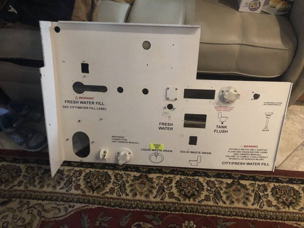

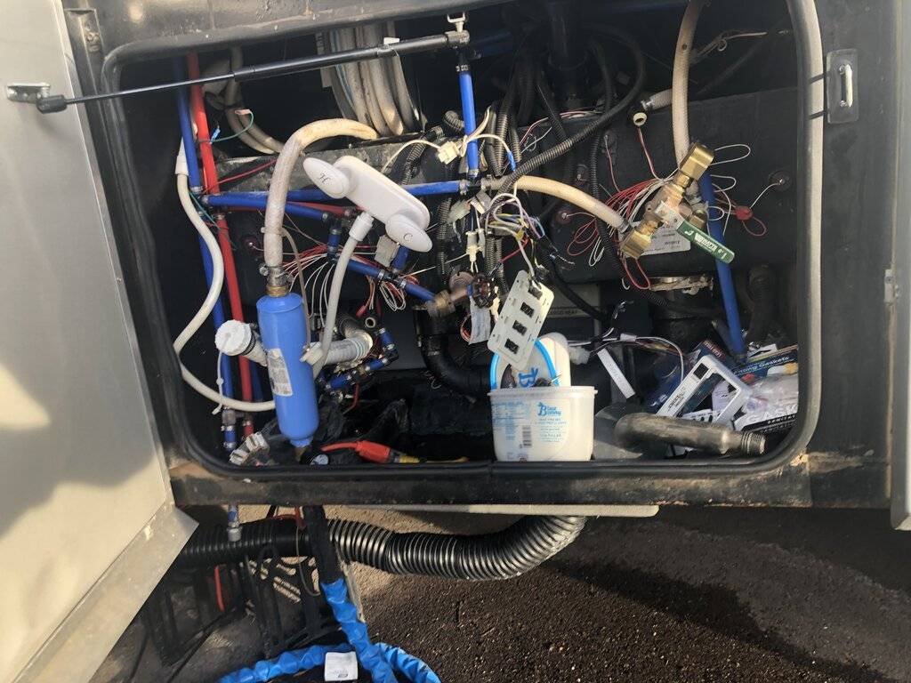

Today, I started to tackle the slow leak in my RV. It was coming from somewhere below or from the electrically retractable hose reel.

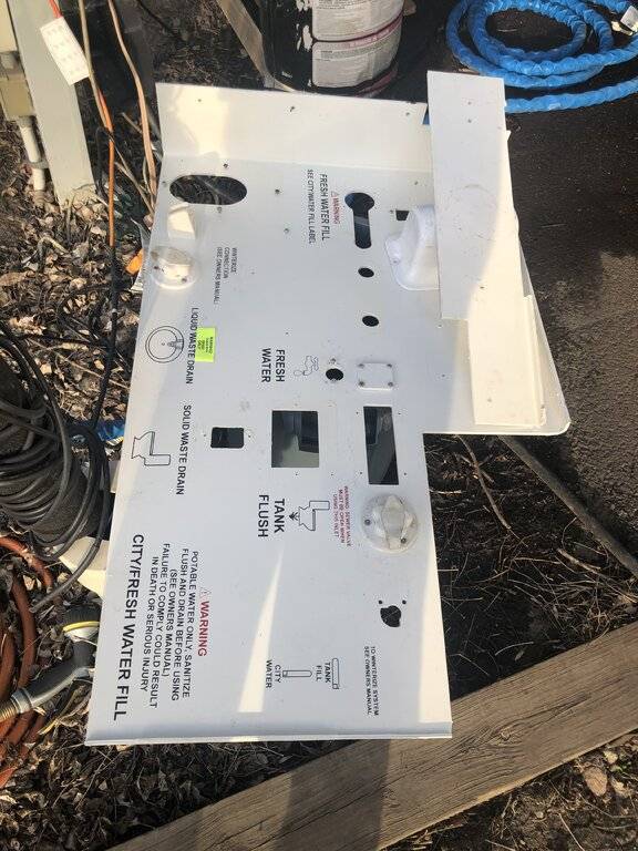

Pulled the service panel. Not made, no designed to be removable.
Whilst trying to remove it, I broke the right flange that mounts to the cavity.

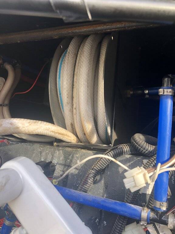

It appears to be leaking from the reel.
Tomorrow, I will buy some hinges and make the panel hinges and removable.
These things were not made to be worked on.

Yes, except RVs add propane, high current electrical, sewer, gray water, water and refrigerant. Add in vehicular systems, too. I got the hose reel out. I am going to install a bypass and work on the reel. I already have an o-ring that is suspect. I will test outside of the cargo bay, prior to re-installing it.
I also am going to install some hinges on the service panel, as I broke one side in the process of removing it (I had to excessively bend it and it broke at the right angle bend - the service panel is recessed in the cargo bay).
