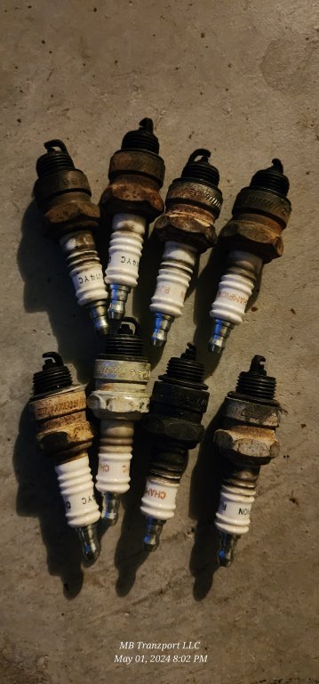

@Big_John This is what he did:
Here's the timing and gap information that he used used below. He found it on an imperial club website... He put the spark plug wires in order (obviously the site I got my firing order from was wrong ), he adjusted dwell to 29. Adjusted idle set screw after he warmed the car up. He replaced the spark plugs. And checked for exhaust gasses in cooling system with the tester.
The spark plugs were SHOT!!!!!!
Now she's running like never before... A few more adjustments and I'll be all the way ready for whatever

Those plugs didn't get that way from anything the first guy did. They look pretty old, and that might have been the reason why it wasn't running well in the first place.
