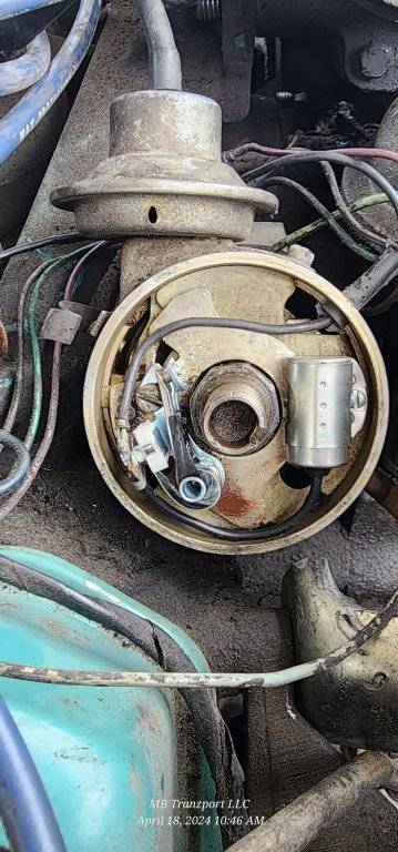

View attachment 658323 View attachment 658319

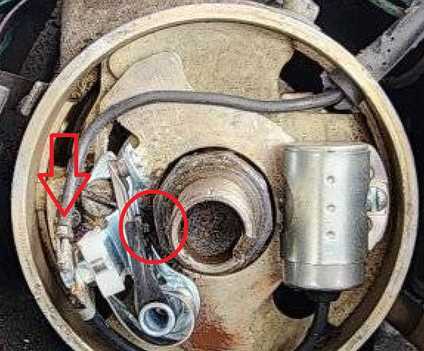

I looked at these pics and spotted two things in the distributor. First is, and I can't tell for sure, but it looks like that distributor wire might be turned enough that the wire connector might be touching the plate. See red arrow.
The major thing is look at the gap between the rotor and the points rub block. That looks like it's so large that the points aren't opening. Red circle.
I think the question to ask is if you know how to properly set the point gap? Not trying to insult or talk down, it's just sometimes guys just aren't familiar with the old technology,
50+ degrees of dwell. :lol: @65 Imperial, the point gap is set with the rubbing block of the points on the point of the distributor cam. .017 will get you there.
From that picture it looks like the points are not set correctly. Big_John circled the area and if that is the case, it will never start. Points are not that difficult to set up. The factory manual should tell you how to do it.
If the points aren't opening he wouldn't have any spark.
No offense taken... I know nothing about cars with points in them... I appreciate the help
