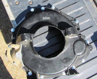

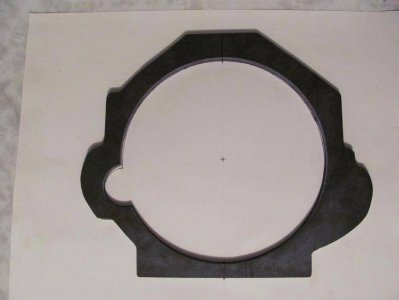

I went to a lot of work so I can replace the Chevy 350 with a Chrysler 360 in my boat... Spent the majority of an afternoon on the bell housing combined with my adaptor plate just to get the mesh on the starter drive to fit properly before the housing could be welded.
