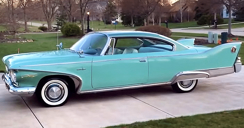

Well the car right now is original and is Turquiose Metallic lower (head light area), Aqua Mist main body and Turquiose Metallic roof.
So I would have thought the paint code on the tag would read KJK, not KJ3. Don't know what the 3 stands for. So white is not the only lower color.

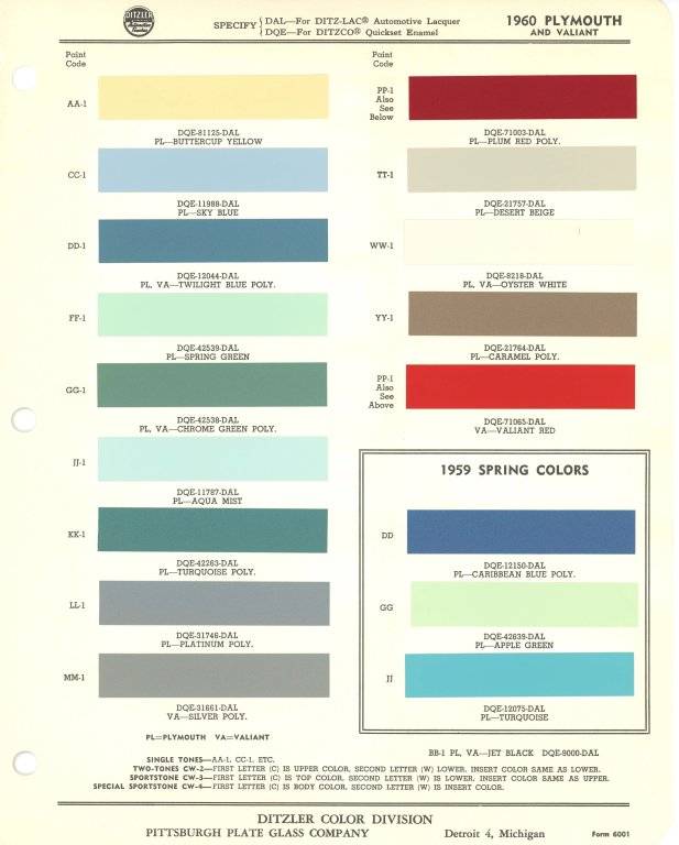

The footer of these paintchips may explain it.
I believe any tasteful combination of paint colors were available as two tone.

The '3' indicates the car got the Sportone paint configuration that included those two colors.
There were at least 33 two-tone and Sportone combinations offered in a wide variety of colors.
