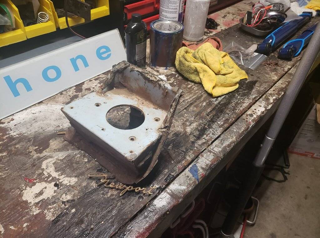

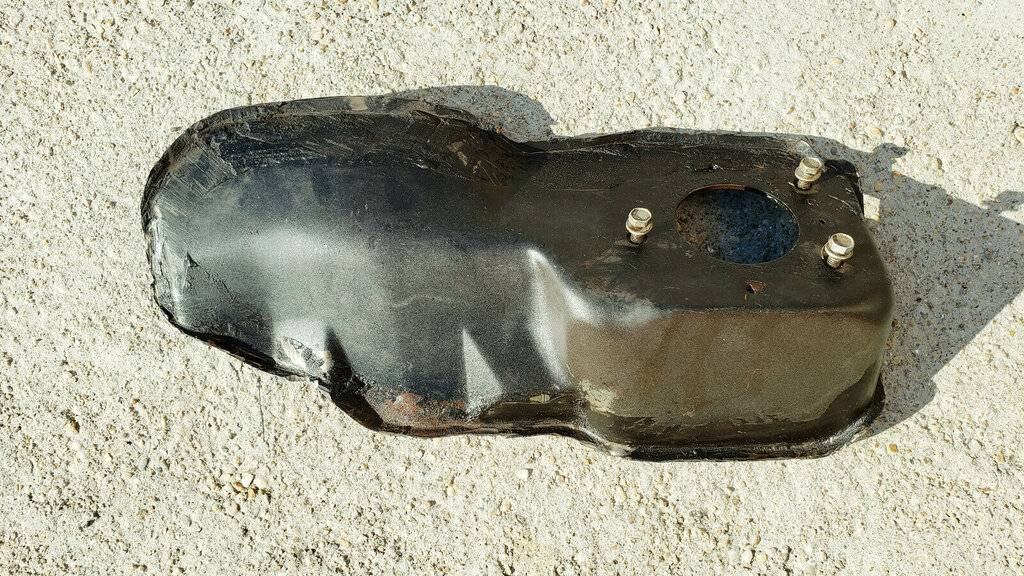

This is the picture I got of the "hump" fabricated for the Chryslers. Were they all like this? Did each assembly line come up with their own design? I do know by '62 there was a more refined hump design.

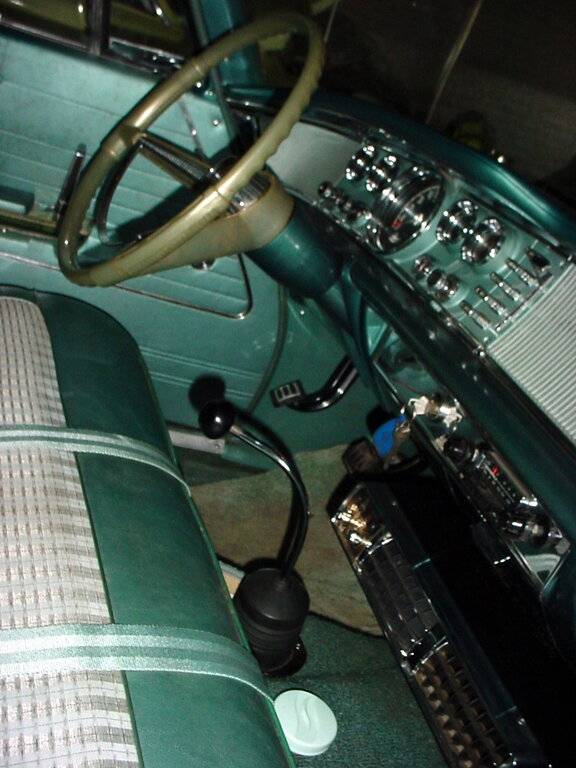

Were ANY floor shifts installed at the factory in 1961? I thought they were "over the counter" sales and either installed at the dealer level or by the owner. Perhaps a template was included in the kit. If true than no two will be just alike.
Yes. There were floor shift cars available from Chrysler. As Ian states in that thread it was only because of the astradome. If not for that they would have all been column mount.
Dodge and Plymouth did not have the astrodome dash. Unlikely any of them were factory equipped with a floor shift for that reason.

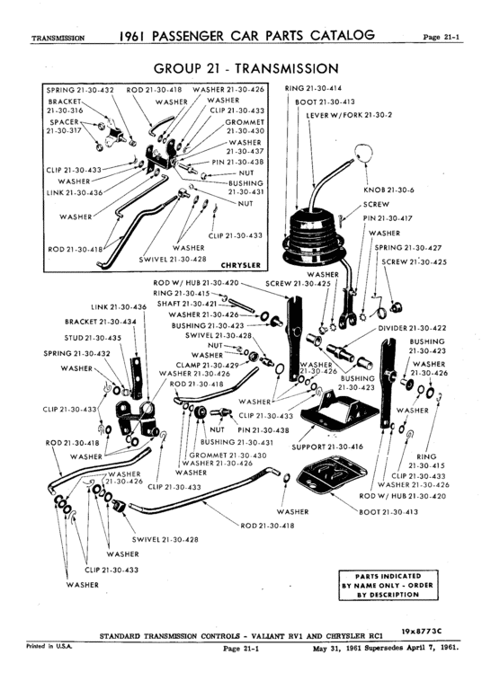

Ken,
The shifter mechanism set-up is different between the Valiant and Chrysler models.
In my other post#15 included the page from the 1961 Dodge only parts manual that shows the valiant shifter set-up.
This page is taken from the 1961 mopar parts catalog that includes all models.
Note the inset at the top left of page that shows the shifter set-up for Chrysler models.
Hopefully this will info will be helpful to anyone swapping in a manual floorshift.
