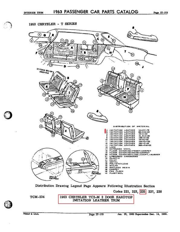

This is new territory to me. I'm not familiar with the Pace setter cards. It appears that they are based on the 300 model and are a special sub variant.
We see the second digit coding, the 0 Zero in the second VIN position, designating a sub model or "special" model used in later years to designate something similar like the 66 S/S Darts, the 67 S/S Coronet and GTXs, and 68 S/S Hemi Darts and Barracudas. They ar3e all social purpose and built version of an existing model.
So it appears to me that the Pacesetters were a limited run sub variant of the 300 meaning they would have some of the same characteristics of the 300, like the interiors, yet have enough changes from he original model to warrant a sub variant and different VIN. Its not unusual to me to see the interior code for both the 300 and Pacesetter.

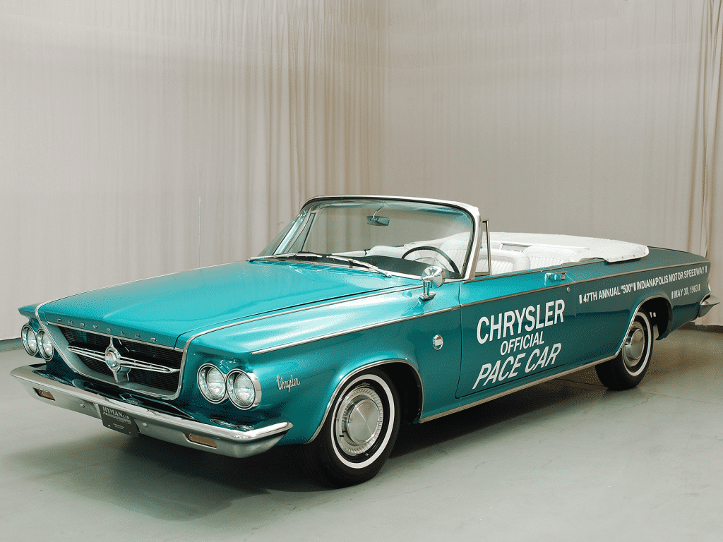

If it were a J letter car, I believe the VIN would start with an 84, not an 80. I also do not believe this car is a Pacesetter, as that would have been a convertible only in the 1963 model line up to my knowledge. I believe it is a regular 300 hardtop. Here is a photo of what the original 1963 Pacesetter would have looked like:
and here is an image of a regular production Pacesetter that did not have lettering on it as the real car did as shown above:
The factory Pacesetter cars did not come with the Ram Induction engine at least standard either and if one was even available from the factory it would have had the 150 mph speedometer also as @Fury Pursuit pointed out.

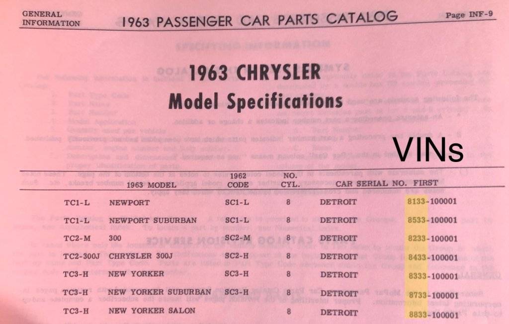

I don't think we're quite there yet. Getting late and I can't look further tonight, but from what I've found so far:
300-J=84; 300 "no letter"=82; 300 Pacesetter=80. Both body-digits do match/carry between VIN plate and body tag. The blue convertible is 805 (5=conv & only Newports (81) and 300{no-letter} were available as it); OP's is 802 (2=2DrHT). They did, indeed build about 370 "802"s (and somewhere around 1500 "805"s). I'll try to tighten up those numbers' bracketing tomorrow.
I think it "is what it is", albeit quite bastardized?

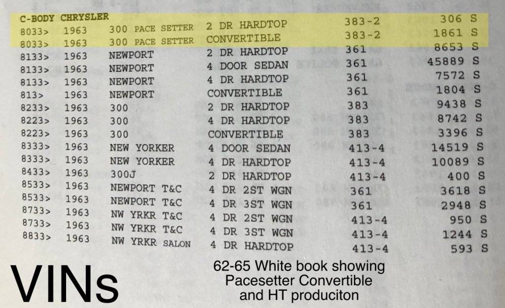

Some documentation to support your post.

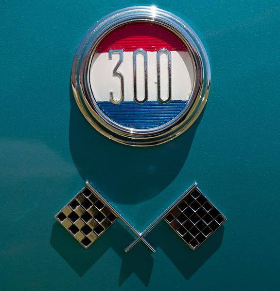

Thanks for the clarification that the Pacesetter models did apply to two door hardtops as well then. For convertibles, the 300 round emblem on the front fenders for that series, seemed to be a hallmark of that series but apparently it was only placed on the front fender on convertibles since they don't have C pillars. So now I am wondering what distinguished a 2 door hardtop as being a Pacesetter vs. just a regular 300? I also find it curious that the Pacesetters were also slotted in the various series as the very base models, even below the Newports.
Also, why are Pacesetter models called out as 383-2 whereas regular non letter 300s were just called out as 383s (implying they could have been either 2 or 4 bbl versions)? Were all Pacesetters really only available as 383-2 engines? Since this is a chart for sales figures, it implies that all non letter 300s were only 383 engines and were not available with 413s as an option, as was the case in 1962 at least?
I think product planning was a bit of a mess in 1963 if this is all correct.
Given that the Pacesetter was introduced late year and given the only numbers left to use in the VIN were 6, 9 and 0 and given the use of the number '0' (zero) to designate specific sub models or variants, I don't think the use of ascending numbers designating an increasing upscaling of the platform applies in this instance.
In my opinion, this is just an editing issue. As there is no 383-4 available that model year, there is no reason to list the -2 on the Pacesetter as there was no -4 available. The -2 designation could be omitted just like it is on the 300 listing. As there is little choice for optional engines that year, the base or only available engine available is listed. Other documentation shows the 413-4 was an available option in the 300. It may have been best to either list the engines as 'STANDARD' or to omit the listing entirely for clarity and to prevent confusion just like we're experiencing.

The "Emblem" mentioned above - below the 300 badge; checkered flags (not on Hard tops I guess)
