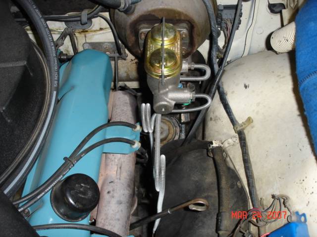

I converted my 64 with a master cylinder from a 67 . I ,ll get the pt# if you want it.

Hey Dan on your 67 MC swap where did you purchase your flex brake lines? And how did you plumb it to the proportioning valve block(since the old one only had one line as opposed to the new one having 2)?
Thanks !
Thanks !

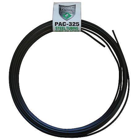

I made the brakes lines from this style of brake line, almost impossible to kink when bending. The armor you can buy from summit etc. The original distribution block I reused as I kept mine drum . I put a flare plug in the rear brake line fitting in the junction block . I then used a union to attaché the rear line to the outlet of the master cylinder.
Awesome! Thanks Dan!
Ok Dave do you have a picture of your distribution block? How did you connect the two new brake lines to the factory drum distribution block?
