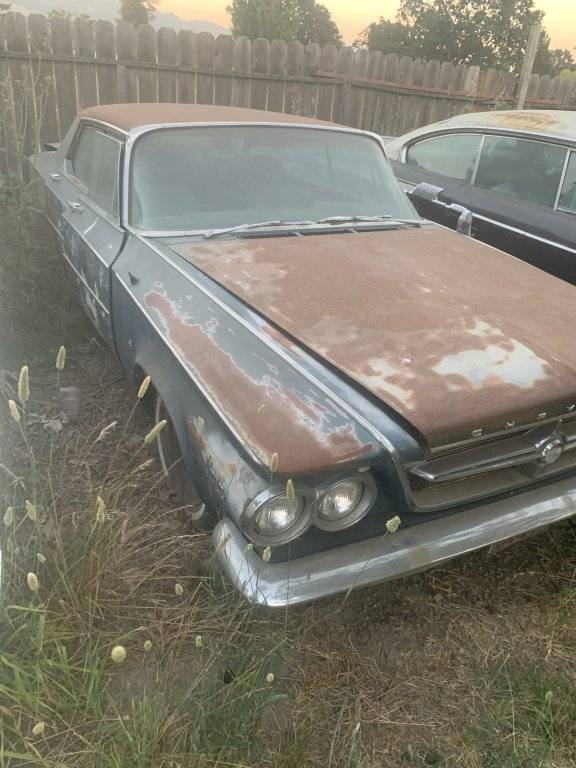

As far as I know there is no reproduction for 63/64 Chrysler rear window gasket.
I would not recommend universal gasket material.
Reusing your original or finding a used original are your options.
I have one on this 63 300,but I’m VERY busy at the moment.
Check back with me in few weeks if you don’t find one sooner.
