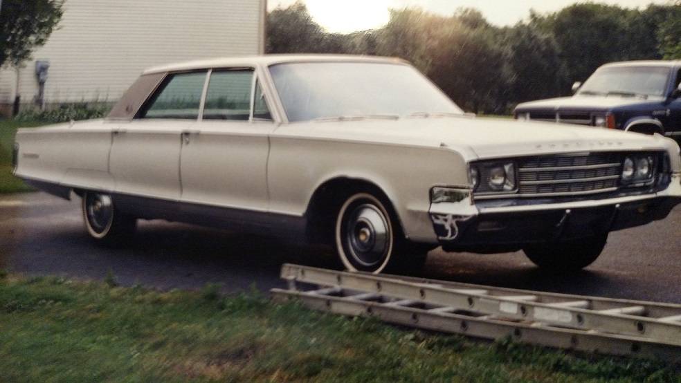

We are re-doing the brakes to get her back on the road then will be getting the interior re-done. Next will be going through and upgrading the entire suspension and steering with Firm Feel parts, changing the color of the car from white to black, and Building the 413 that is in with twin turbos and adding a GV OD. That is the plan anyways.
