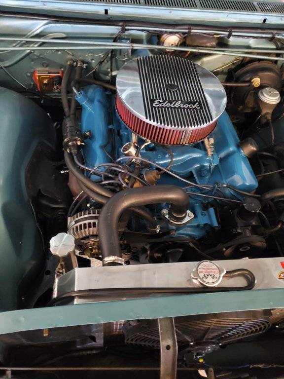

Cbarge.... I'm very interested in this set up. Where do you get it? You posted a pic, with no other info.
I did the wire to alt already... thanks! Great suggestion. It makes a huge difference. Nice to know I'm not pushing that much amperage through the firewall anymore.
