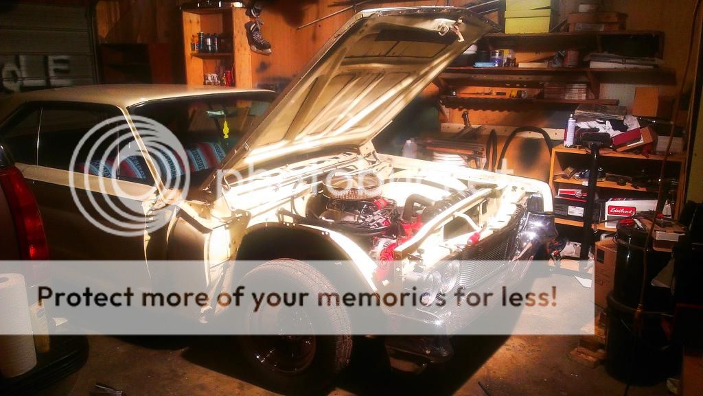

Hey guys, I'm new here. I bought this car neglected a few months ago and have been working away getting her back into shape while making some needed performance upgrades. Hoping to learn more and contribute to the site.
Cheers, Andrew
Specs:
1965 Chrysler Windsor
361/727 auto/very likely #'s match
8 3/4" open rear diff
Original color combination
Edelbrock Dual plane intake
Holley 670/vacuum secondary
AR Engineering throttle brackets
MSD distributor/coil
Hooker competition hedders
BFG 215/65R15 front ~ 225/70R15 rear
Dynamark rims w/spider caps on front

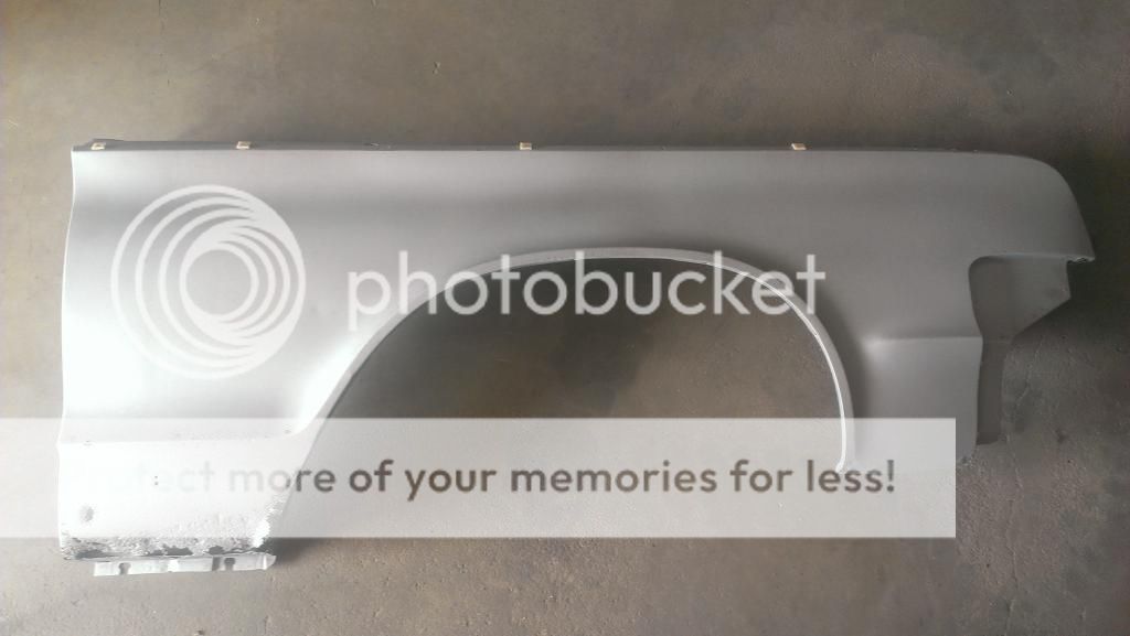

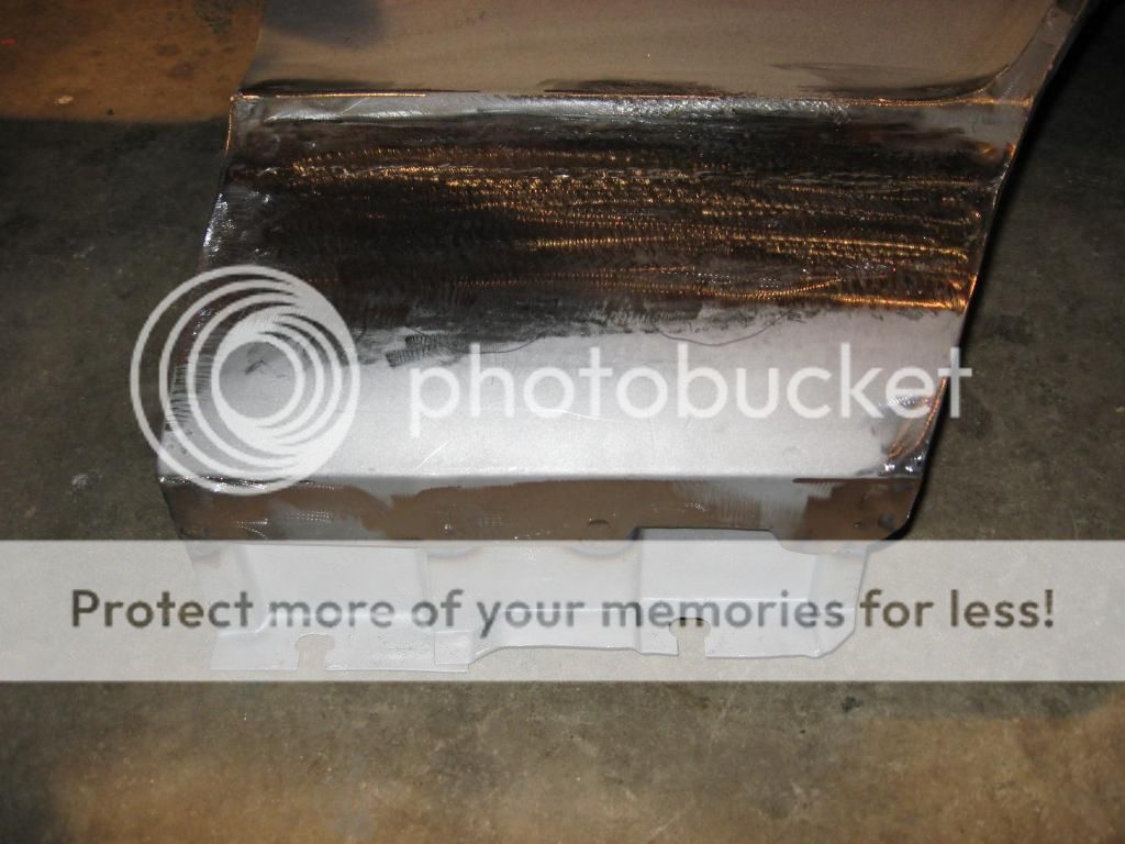

My metal guy got the fender done and I'm really pleased. He filled all the trim holes and aerial hole, also replaced the lower metal with some fabricated patches.
