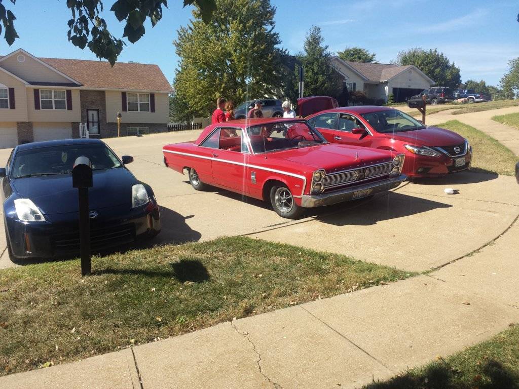

I just bought the car this weekend. It has sat for 13 years. I did get it started and cleaned up a bit. The headlights, blinkers, taillights all work but none of the dash lights work. The ones that push and twiston the brass circuit board any thoughts. All of the qiring ia in great shape. Thanks for any help
