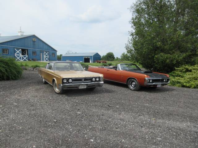

Thanks Big_John and 300Rag, I'm addressing you both on this one as I was going to ask Big_John the question of " Do the brake lights and turn signals not share the same ground?" The turn signals do work manually , I have to flick them by hand, need a new flasher and one cam is broken in the turn signal switch.
Could the defective flasher be affecting the brake lights? To your knowledge, how many grounds should I have in the tail lights?
Thanks for your help guys, it will be a few days till I get to it, my 67 Newport goes in for saftey tomorrow, knock on wood!View attachment 604636
