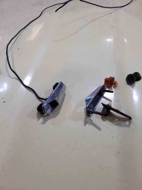

While working on cleaning things up, I tried to take apart the hood mounted turn signals.
As you can see things didn't go so well.
I'm in need of 1 complete hood turn signal but will happily buy a set.
Picture for reference.
TIA
The lens isn't as much of a problem as the rust that has eaten the base and frozen the threaded the light bulb socket to the point it's nearly wrecked trying to get it apart.
soak the base in vinegar, mod podge to glue the lens together. then dip it in future floor polish. works great
You can actually glue those back together - as long as the glue is clear, it still works! Been there done that!
On my 67, both lenses and bases fell into a pile on my workbench. Took a few hours to piece back together with superglue, then when assembled I dipped in epoxy and let it set, then sanded down the outsides so it would fit back into the housing, polished the exposed lens and "Bam" good as can be. The prices of the 67 turn signals and lenses made me get REALLY creative.
