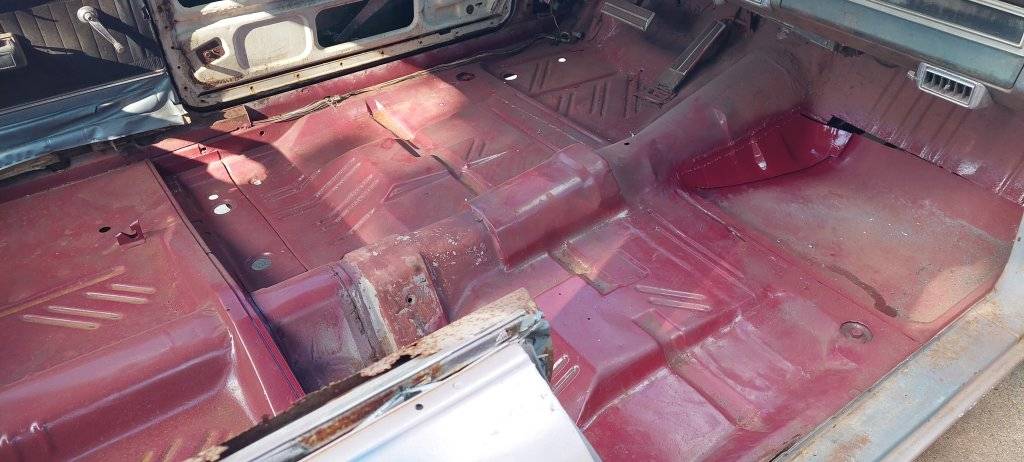

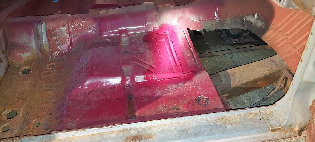

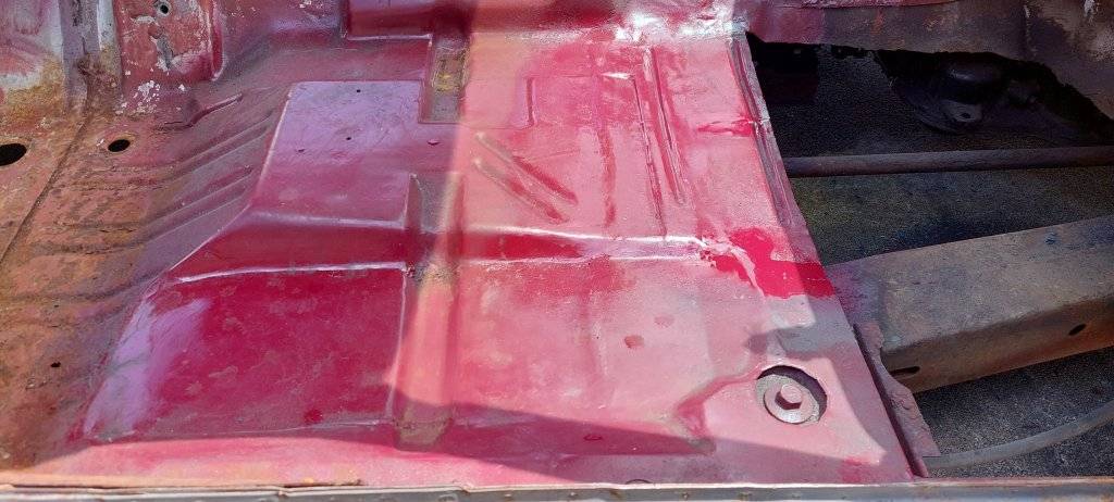

1966 Fury III - Unfinished Project

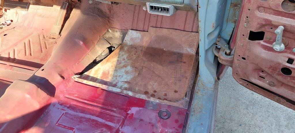

Top section shaped and welded in.
Will grind down tidy tomorrow.
In my haste to complete welding last night I put too much heat into the panel and warped it. Sliced a couple of reliefs in, beat it flat and welded up.
Calling that center section done.

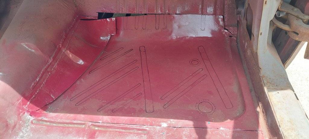

Next up, front footwell.

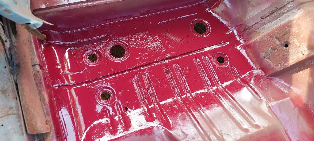

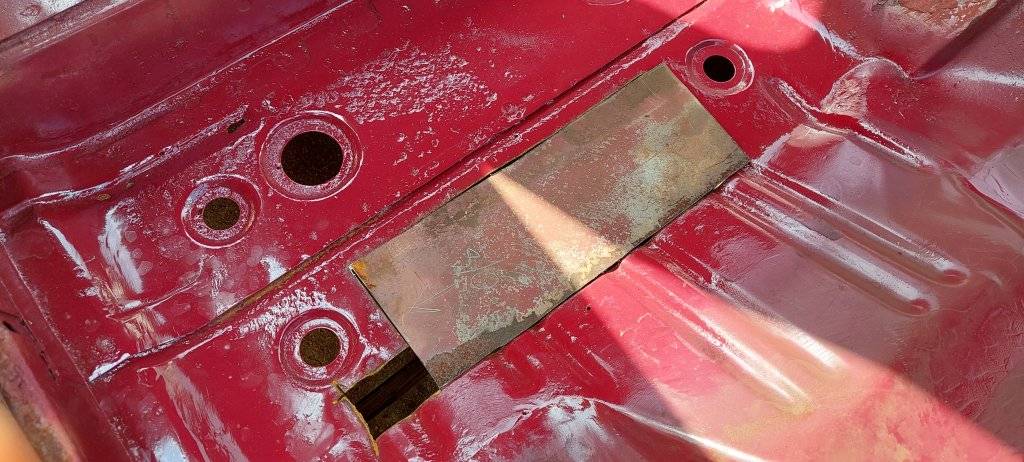

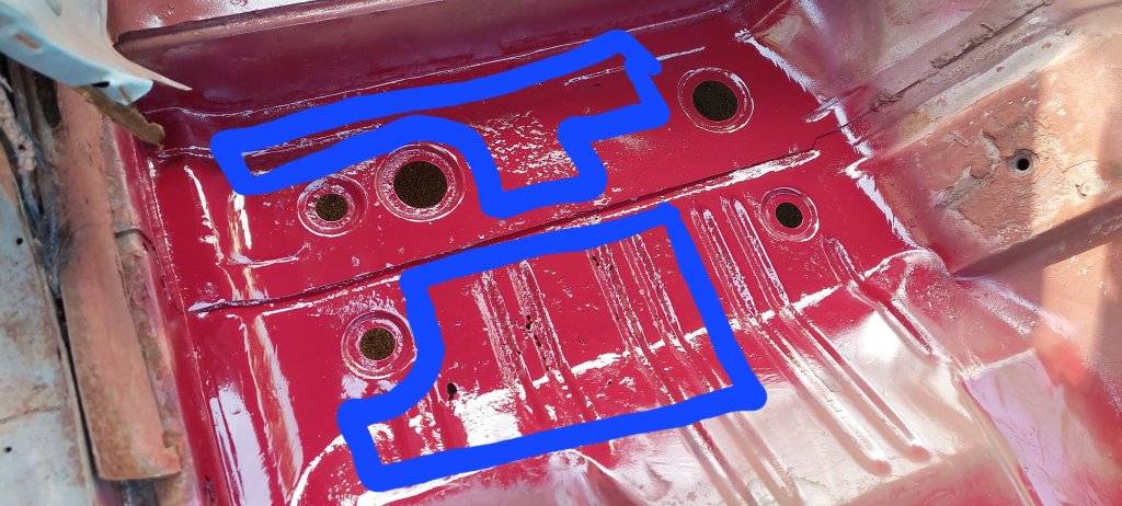

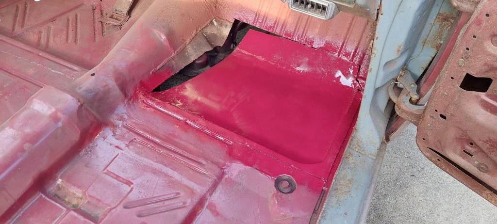

Late start to this evening. Cleaned up all the rust and old paint, underseal and trash from the passenger rear footwell.
Not overly bad, most of the rot is as expected, in the ribs.
Plan of action is to cut out these sections and replace.
Phil

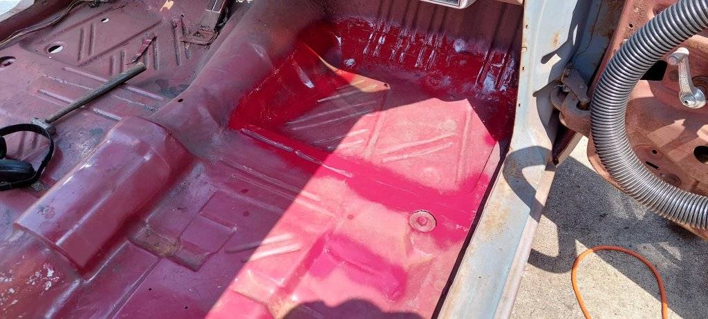

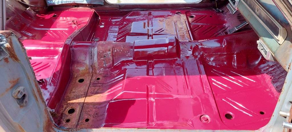

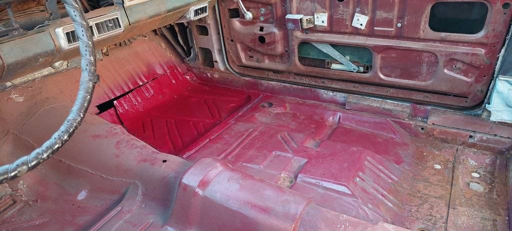

First bad weather in weeks, it's been hanging out over y'all.
This is just, well, sticking metal back together right now.
It's gotta come apart even more yet, too...

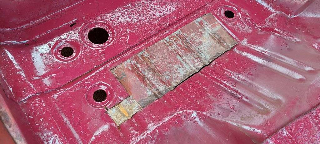

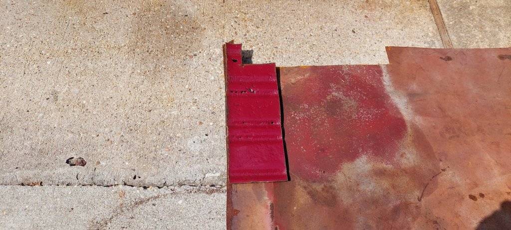

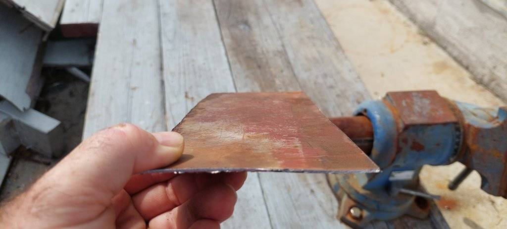

A little more metalwork tonight. Everything you can do with real basic tools at home.

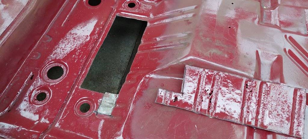

Old hood skin makes a good replacement panel. Place the piece removed on it and draw around with a pencil, adding extra length on one end for the metal taken up by the ribs.
Chop the shape out carefully, keeping to the outside of the line.
Test to make sure measurements weren't completely wrong and there's enough metal to fill the hole. Did good.

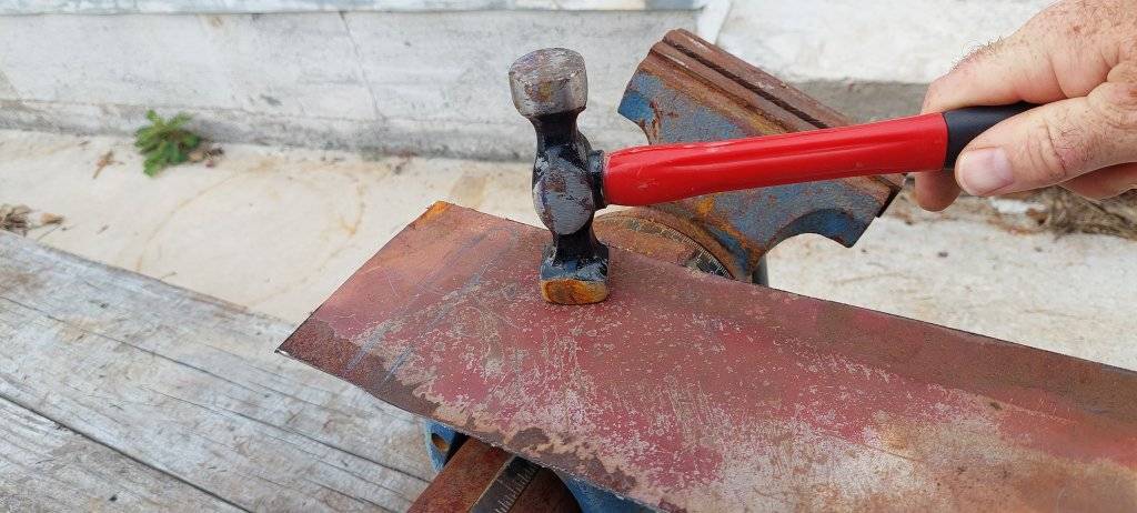

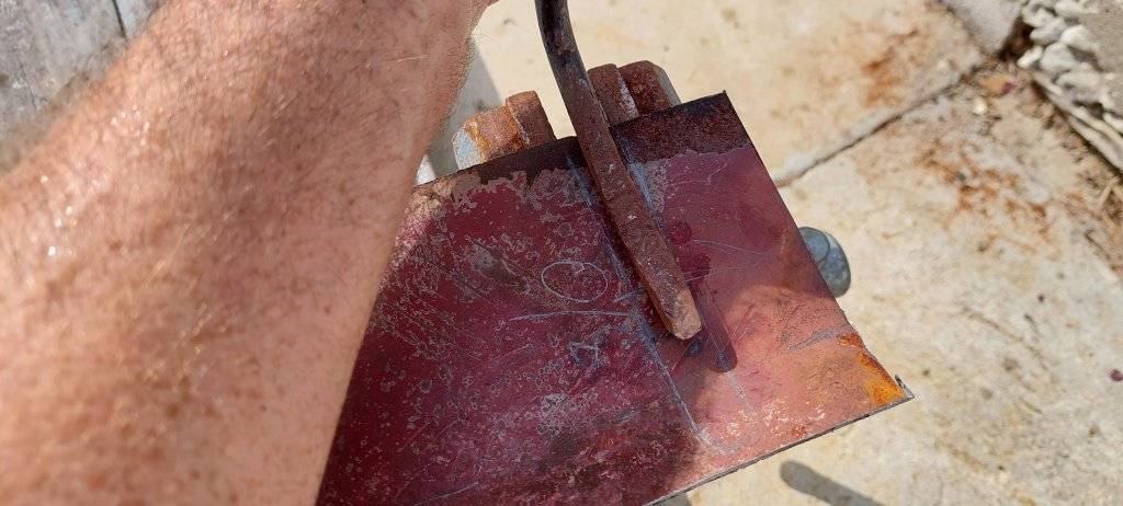

The section of metal cut out was on one of the body lines of the hood. Hammer on the anvil of my vice to flatten it out.
Calibrated eyeball says that is good enough to start with.
Open the jaws of the vice to the width of the rib to put in and beat a piece of round bar into the sheet metal. This will form a V shape, which can then be turned over and have the edges hammered down with the square edge of the panel beating hammer.
Measure each one as you go, because the metal folds in with each rib you create. If you measure them all at the start and just hammer them in you'll be all out of line by the time you get to the last one.
Any compound curves can be gently bent in by placing the round bar in the groove, all in the vice and bending gently.
Mark up what needs to be trimmed off ready for welding.
Total time: 40 minutes
