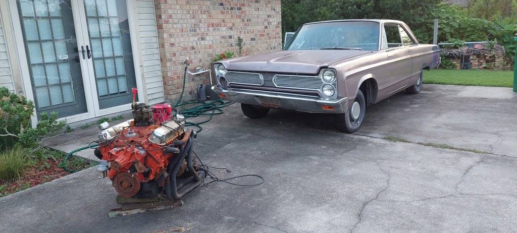

It sure did. Reassembled, ready to test tomorrow. I've got a new transmission mount to go in, I'll pull the intake and distributor off and hoist it in if tomorrow allows (took a vacation day).

Checked to see that I had reassembled the engine correctly. Sounds ok. One cylinder is still a bit low compression but it's still firing on all 8.

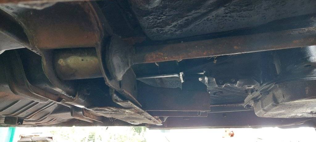

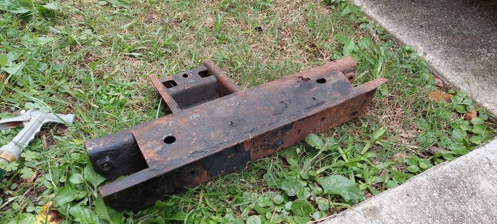

Somebody (a mechanic, no less) decided this was safe to drive.
The reaction tube was loosely held in place with two bolts. I need to get the other 8 and fit them back in.
The reaction tube was bent. Unsure why, so I straightened it back out.
It's back in with the two bolts but I'll have to see if putting the weight of the car on it will push the outer arms back into line. It's been sat with that undone for a while.
Got the transmission mount in though.

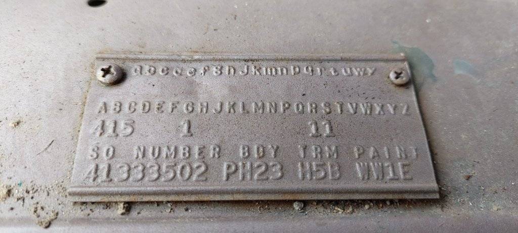

Also, hot on the heels of another thread, can anyone tell me a bit more than I already know about the way my car left the factory?
Thanks
Phil
PH23: Plymouth, High Price Class, 2 dr hardtop
H5B means: High Trim Grade, bench, vinyl seat, Blue trim
41 means 318 2bbl poly engine
C5: TorqueFlite Auto Transmission
column G: 26" radiator Yoke
Column R: Radio, AM music master economy
Column S; Heater, Air Conditioning with heater

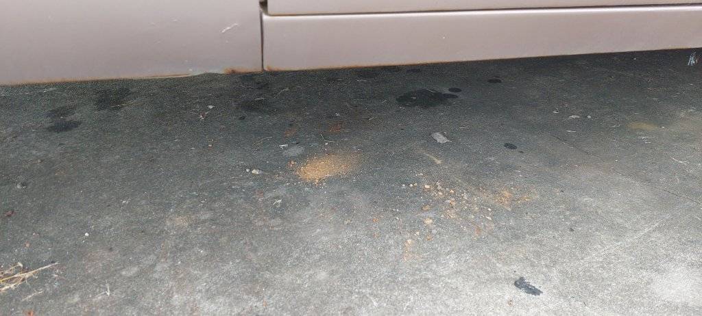

Bought some new grade 8 bolts and fixed the reaction tube in place.
In adjusting the position slightly, I liberated some history.
Yup, definitely a Mississippi car. Yellow Mississippi clay all fell out.

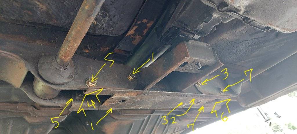

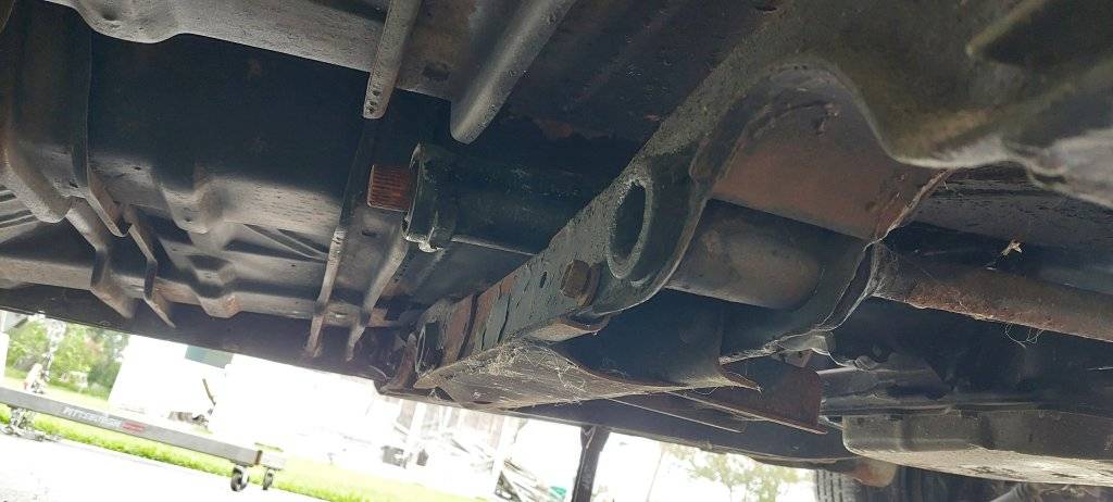

How did you get the trans mount to line up so you could install the bolts? My car has had the same issue for a long time.
Having the correct bolts really helps- with the taper thread that'll catch and pull themselves into line. Mine are just regular grade 8 bolts and washers.
½" dia, ¾" head, 13tpi and 1¼" long. (Listed as 1/2-13 1-1/4 GD8 at the store where I bought them, in case you too are missing any).
They're a bit too long even with the washers but 1" bolts would be too short. Nothing fouls anything else from what I can see.
Support the gearbox up away from the mount.
Grease or oil the mating faces of the beam and recievers. The beam must slide easily.
1. I loosely fitted the center two on the left, that gave a pivot point.
2. Push up on the other side with a jack.
3. Insert other inner bolts.
That leaves it sitting with the lower bolt holes splayed out.
4. Jack up on the outer edge.
5. Fit bolts, then the other side the same method (6, 7).
After that fit the two vertical ones up inside tightly, and then tighten down the rest. Do not use the vertically mounted ones to pull it into line. All it does it stretch the metal out of shape. Push it upwards with a jack. Just take care to not lift the car up off the stands!
Took about 30 minutes, working under the car.
Phil

Thanks, Another afternoon project.

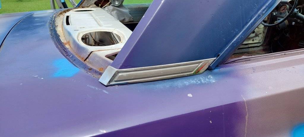

One of life's little mysteries was annoying me so I decided to fix it today because the weather's nice.
Not entirely sure why this was done. We may never know.
Zip pop crackle damnit crackle fizz.
It's not quite the right profile but it'll do. Ain't nobody gonna see it. It's all one piece again, at least.
